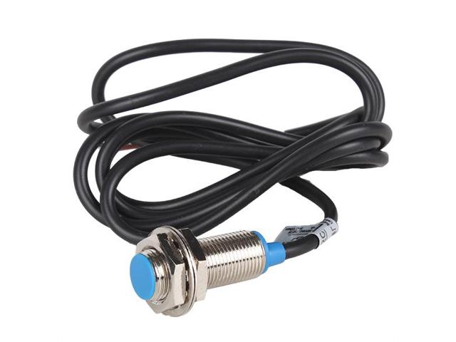

I should have been more specific about the Hall device it is a " NJK-5002C Hall Sensor Proximity Switch NPN 3 Wire. "
I cannot find a Datasheet on this being Chinese?
I have attached a picture of it.
The Frequency Measure sketch is nice, thanks for the link, this is very helpful.
I will try to get things working using this sketch as it does seem to simplify trying to map things correctly---well maybe:)
