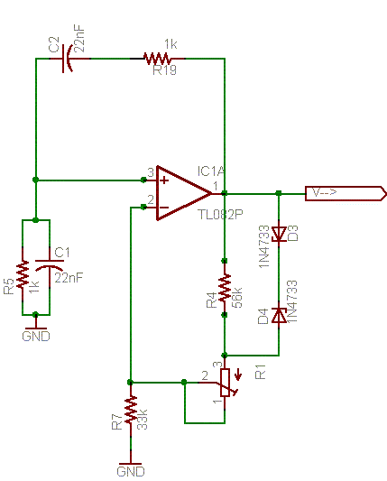

How about a wein bridge oscillator?
Edit: yes, I edited the schematic just to change the diodes to 5.1V zeners.
A Wien Bridge oscillator has two resistors or capacitors that must be closely matched.
I doubt you will find closely matched parts that are variable.
Yes, however the pot which controls the frequency is not one of those pairs. It worked for me just fine, but I'm not sure if it went as low as 1kHz.
Millions have been built using stereo potentiometers, and they work perfectly fine - both commercially and as home projects.
A wein bridge oscillator has two matched pairs of components, two resistors and two capacitors. And the frequency of oscillation is proportional to their product. So if you wanted an oscillator with a relativly narrow frequency range (One decade, say), you have two fixed capacitors, and the resistors are given by a 'dual ganged potentiometer', these are basically two potentiometers glued together with one knob, so that turning the knob changes the two potentiometers equally.
If you want a wider range of frequencies, you use rotary switches to select different capcitor pairs. So you could set the capacitors to 1uF, and vary the potentiometers from 1k to 10k to get one frequency range, and then use the rotary switch to make the capacitors in the circuit 10uF, which, for the same potentiometer range, will give a different, non-overlapping frequency range.
There are even ways to avoid using dual-gang potentiometers, by having a gain stage in the feedback network, but you'll have to find a specific circuit to do that. I think hunting around on google will find one, otherwise you'll have to consult a book specifically about oscillators.
My Wien bridge oscillator uses a dual variable capacitor with trimming capacitors built-in for exact matching. The circuit used to have a FET input but now has a FET-input opamp.
The ranges are selected with matched 1% resistors.
Amplitude stability used to be done with a light bulb but now is done with a FET automatic gain control circuit.
It is 10Hz to 100kHz at 0.04% distortion.

Beebop: What's the purpose of D1 and D2 ? :D

They're non-linear components to stabalise the gain. For stable oscillation, the gain of the apamp must be exactly three. If it's less, the oscillations will decay away, if it's more the oscillations will grow without limit (Until clipping appears in the opamp).
When the amplitude of the oscillations are low, the diodes don't turn on, and the gain of the opamp is grater than three (Asuming the potentiometer is set correctly). As the amplitude grows, the diodes start to conduct, shorting out the resistor they're in parallel with, lowering the gain to less that three, so the oscillations start to decay. At which point the diodes stop conducting, and the gain rises. Etc...
They serve the same purpose as the bulb/thermistor you see in other wien bridge circuits. They cause more distortion, but are much simpler to use.

Hi BeeBop,
Wow, i havent seen one of those things in ages now, thanks for posting.
Just a tiny problem however...
The two output diodes are connected such that neither one of them
will ever conduct, so there has got to be a problem with the connection
of those two. Perhaps you can find the error and correct this schematic?
Thanks.

Hi Anaximander,
You better take another look at Beebop's circuit. :D

*Looks at circuit*
*Shocked face*
Eh? I have no idea what they're doing, I assumed the diodes were in parellel with each other, because that's how the wien bridge circuits I've built have worked.
