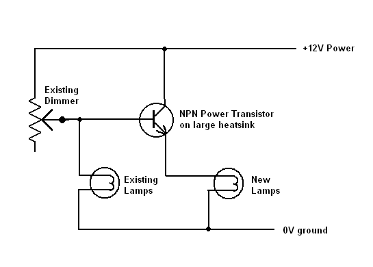

I am trying to figure out how to mirror a manual resistor with a relay. He is my issue. I currently have an 12volt light switch currently supplying power to 2 1157 automotive bulbs you can adjust the brightness by turning the knob on the switch. The bulbs are in the instrument panel of a car and currently has 2 1157 12 volt bulbs.
I would like to install a relay that would mirror the output of the switch so I can install additional bulbs without burning out the switch. So when the brightness is adjusted on the switch the additional bulbs are also adjusted.
I currently have a bosch relay installed, but no variable brightness.
You wouldn't use a relay. You'd use a transistor instead. What electronics parts places do you have access to so we can recommend a suitable transistor?
Too many sites called "electronic warehouse" for me to guess. About the only thing at RadioShack that would work is the old 2N3055. How many extra 1157 bulbs do you want to drive? A 1157 is a dual filament bulb; which filament is going to be on the dimmer? The 27W, 8W, or both?
Then the 2N3055 on a heatsink would work fine for that. Don't forget to resize the fuse for the extra current draw from the 3 8Watt lamps (2.5 amps extra. Includes a 0.5A margin).

Unless the dimmer pot has 3 terminals available, jkantelli will have to have at least one bulb connected directly to the dimmer.

Use the car chasis as a heat sink. Get the correct insulator kit for your transistor and bolt it to the metal work.
using PWM is a good idea and relatively easy to make using a 555 timer IC driving the 2N3055, mosfet would be even better for power eficiency and producing less heat that needs disipating

I like Gordz idea. Get a piece of angle aluminum and mount the transistor to it with insulating hardware to prevent the collector from shorting to GND. Then bolt the angle aluminum to the firewall, metal dash, etc as a near infinite heatsink.
Depending on your skills, PWM can be very easy or impossible. If you are comfortable with soldering ICs, etc to a piece of proto-board, then something like the circuits on this page could be made to work with a few modifications.
