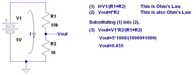

How did you figure this out? I am so confused. I realize that you subtract .45 volts from 5 volts and use 2ma as the power/watts. But why do you have to add the 1k resistor to ground?
I'm afraid that what you realized is wrong. Where did you get the 2mA idea?
Use Ohm's Law. This is a simple voltage divider. See below.
