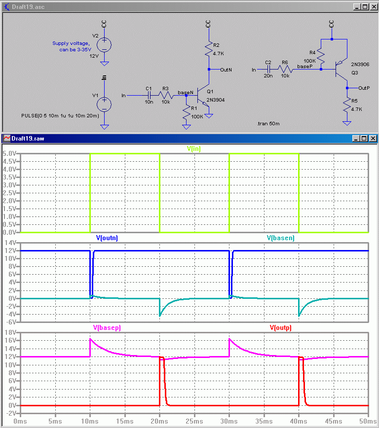

need timer 5 sec on 3-4 hours off i tryed 4060 it works 4 hours on 4 hours off. how can i adjust the off time and the ontime independant?
Look at my posts to this thread.
Another idea is to capacitively couple the CMOS output to the base of a transistor, which amplifies the differentiated signal (which occurs only once per 4hour cycle).
Two versions here, one which has a high going pulse, and the other which has a low going pulse. Load could be a relay. The R3C1 (R6C2) time-constant controls the pulse duration.

curious how did you get 3 different ossiscope displays and the grid?
have yet to even get the grid to show up. YES I have the SHOW GRID checked.
sorry if I kinda changed subjects but I like to copy the screen shot schematics and duplicate for learning purposes.
Click on the Plot Window, Menus change to reflect that the Plot Window is active
Select menu "PLOT SETTINGS"/"ADD PLOT PANE"
Click on any plot pane. Go back to schematic window and Left Click on node to add voltage trace, Left Click on component to get current trace, Alt Left Click on component to get power dissipation trace. New trace always appears in the plot pane you clicked on last.
