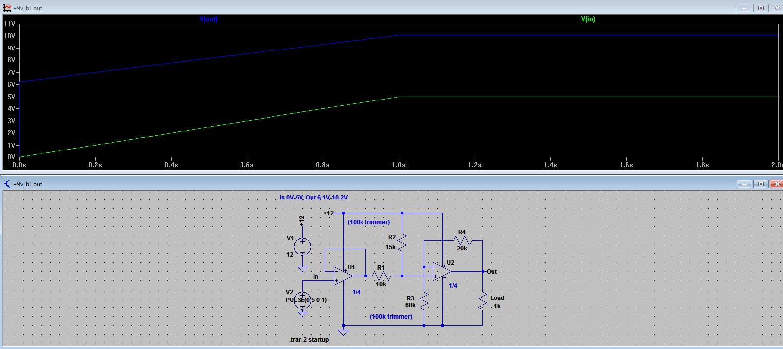

Hi All,
I have a variable voltage amplifier which takes in 0-5v and outputs ~6.1V - 10.2V depending on the 0-5v input. I've simmed it. It works and I"m happy with it. For example you input 0 volts you get 6.1 volts out of the circuit. Or if you input 5v you get 10.2 volts out of the circuit. It's a linear relationship.
I would like to be able to provide more current than my amplifier can handle but still keep the same voltage swings. I'd like to drive 250mA maximum for my variable 6.1v - 10.2 volt signal.
I've never done a circuit like this and upon searching I see a darling ton pair might work for me. Thing is how do I keep my voltages to stay the same? There are also chips I could just, "buy" and they will do what I want but I want to try and find a more creative way of doing it and perhaps cheaper.
Any thoughts or ideas I could try?
Attached is what I have so far.

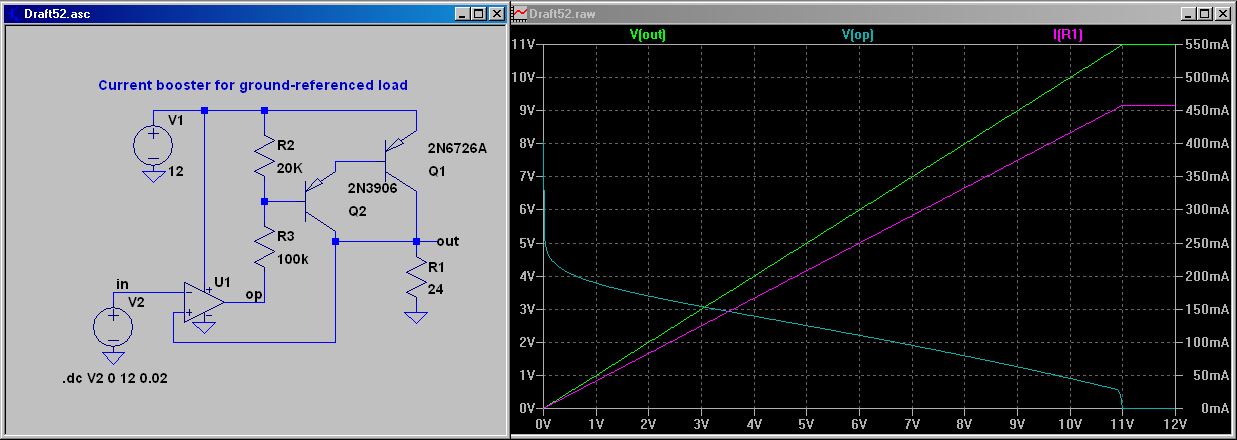

A PNP darlington emitter follower can pull down but not pull up. Since your load is connected to ground then you must use an NPN darlington emitter follower to pull up and a 13.5V supply.
An LM386 has an output voltage drop of about 2V when its load resistance is 16 ohms so with a 12V supply and a 40 ohm load (250mA peak) the output might not reach +10.2V.
Here is how to use a PNP Darlington to drive a ground-referenced load. Note how the output of the opamp stays where a LM324/358 can drive to. Also note that it will pull within a volt of the positive supply rail. This power amp has a gain of 1, so do your offsetting in the first stage..
The X-axis in the plot is input voltage. Note everything is linear until the output reaches 11V.

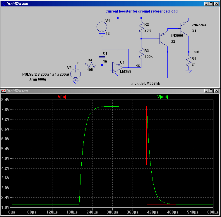

After posting this, it occurred to me to check the transient response. With the extra inversion inside the feedback loop, it wasn't stable, so I added the secondary ac feedback. The transient step response can be tweaked with the feedback capacitor.
