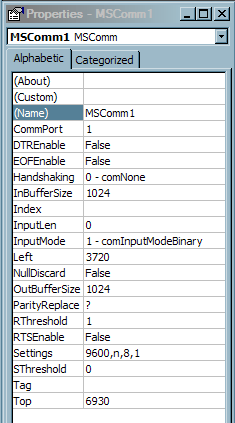

I m tryng to send data from VB through serial communication using MAX232 and read them in a microcontroller. sofar i could manage to send ASCII charactores through VB. I need to send binary value through VB.Lets say if i press a command button i need to send '10001110' value to the microcontroller. what are the changes that i need to make in VB. if anyone can help me please.
my VB code is below

Look at this VB5 subr also the MSCOMM1 setup, I use this for binary i/o.

You may find this subr easier to follow, note the 'open as Binary'.
