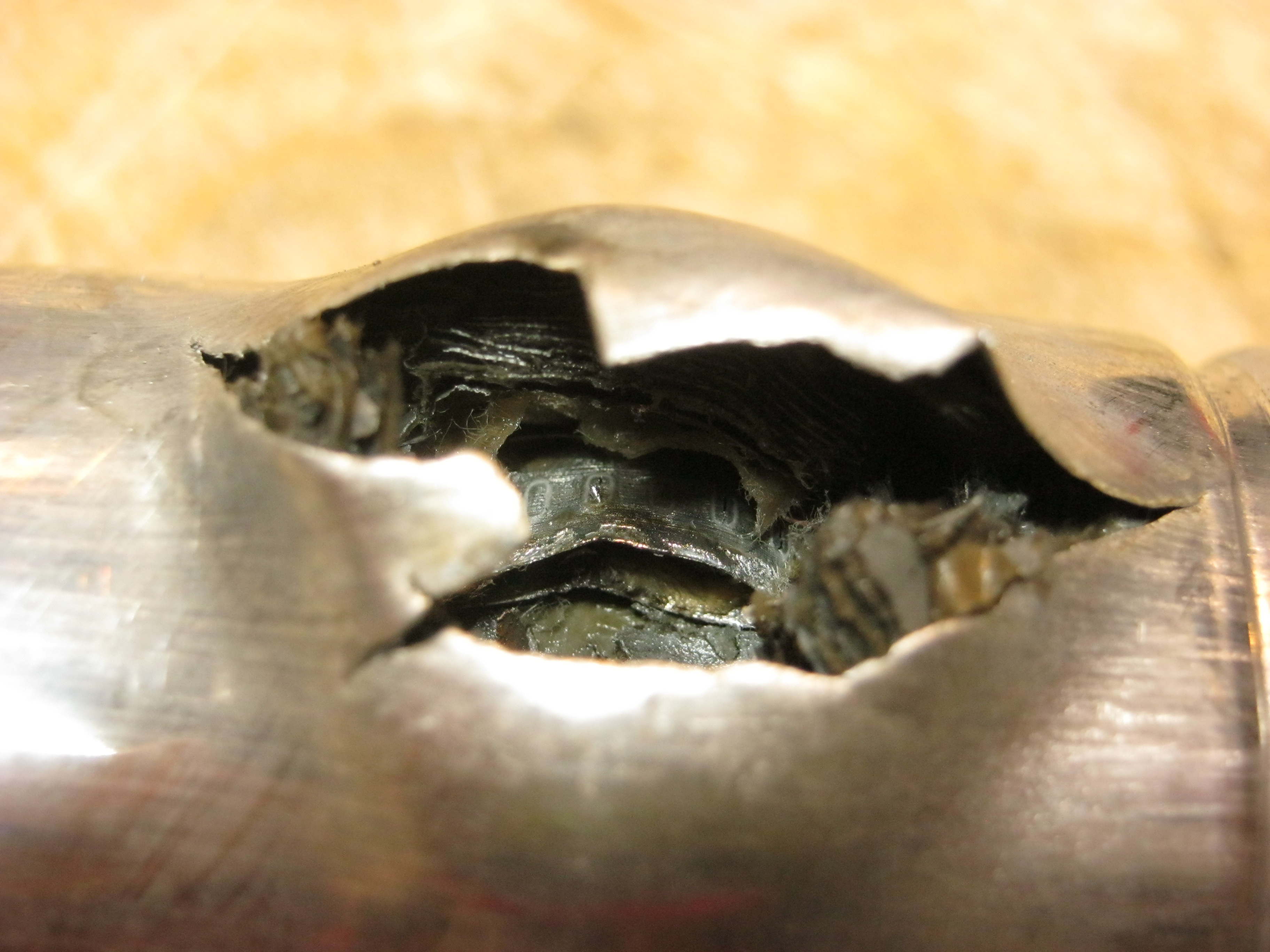

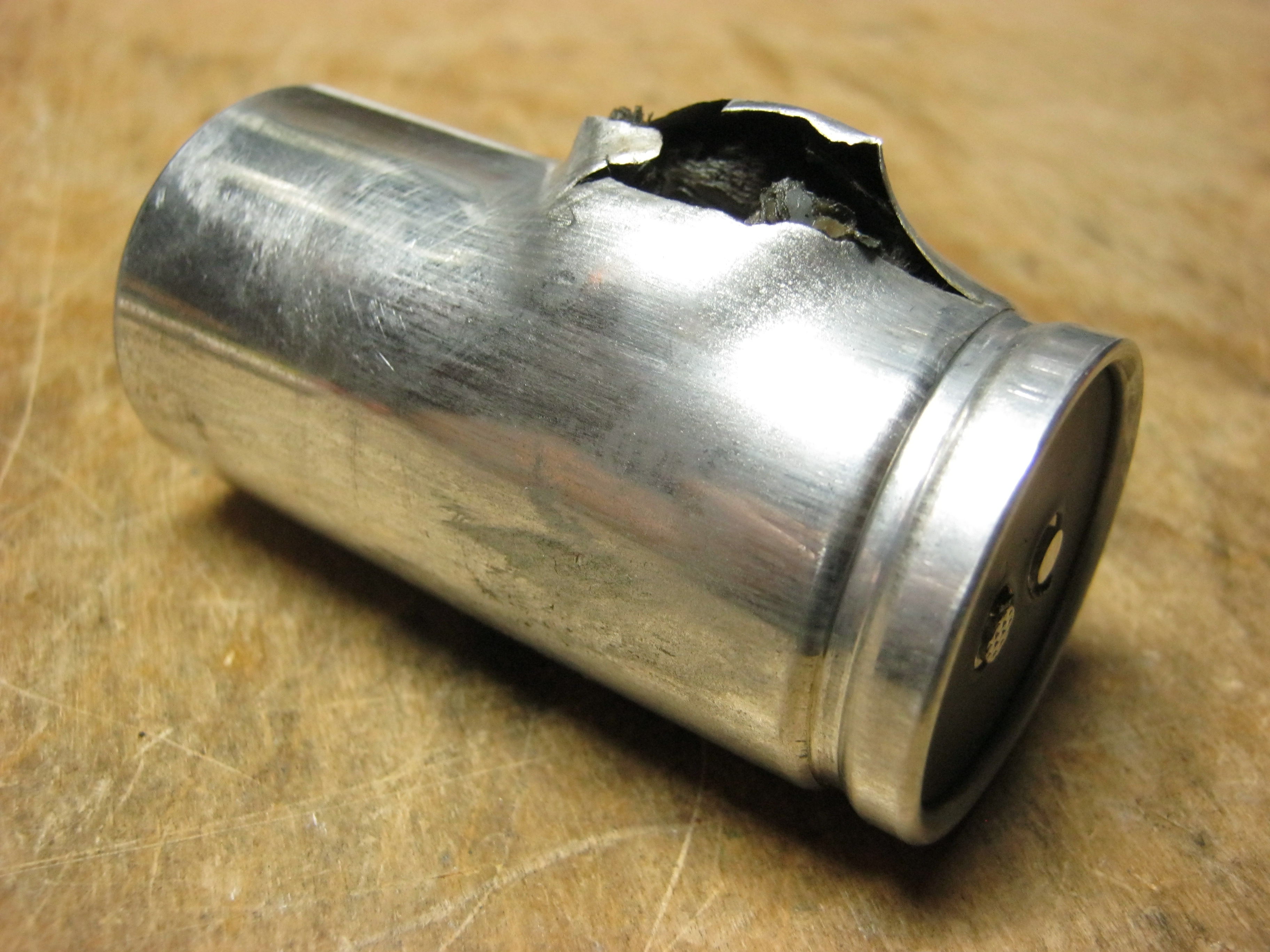

Couldn't resist sharing these images - one of the most impressive failures I've seen for a while. Possibly the most impressive aspect was the dent that it had put in the neighbouring capacitor.

Could you give more details. Very old cap?
Vented capacitor?
Apart from the gaping hole in the side, where is the (intentional) vent supposed to be?
If I'm getting the terminology right, the "vent" is the cross-shaped indentation in the top of all modern caps which is supposed to rupture in a controlled manner and prevent dangerous explosions in the event of a build up of pressure. This does have one, but of course it's out of sight in those pics.
It's not very old, actually, only a few years. The heat has caused the plastic wrap to come off, which gives it the old-fashoned metal can look. Root cause isn't established yet - we did see some early life failures of these, which where put down to a bad batch, but it's possible that something else went wrong here which caused a significant over voltage.

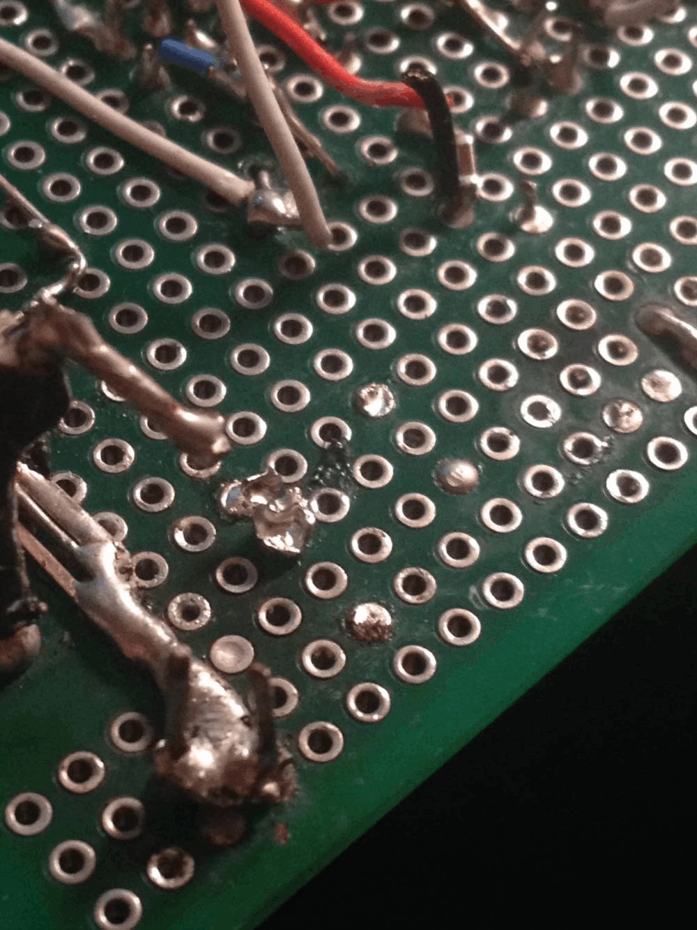

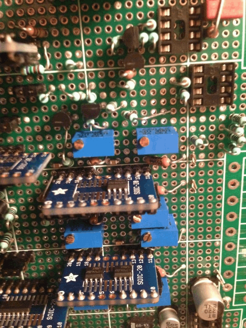

Internal contamination. There once was an 220uF 16V cap here locked to a 5V supply. The type of cap is the same as the bottom right corner on the board, the name of the caps were not disclosed to me. Serviced 5 month 27,2017.
A small contaminant can expand casing an eventual cross short in an isolated pocket leaving no room to make it to the vent. Or traverse the remainder of the material.
BT series, Nichicon or Seika, leaning towards Seika as the design look is more like on this board.

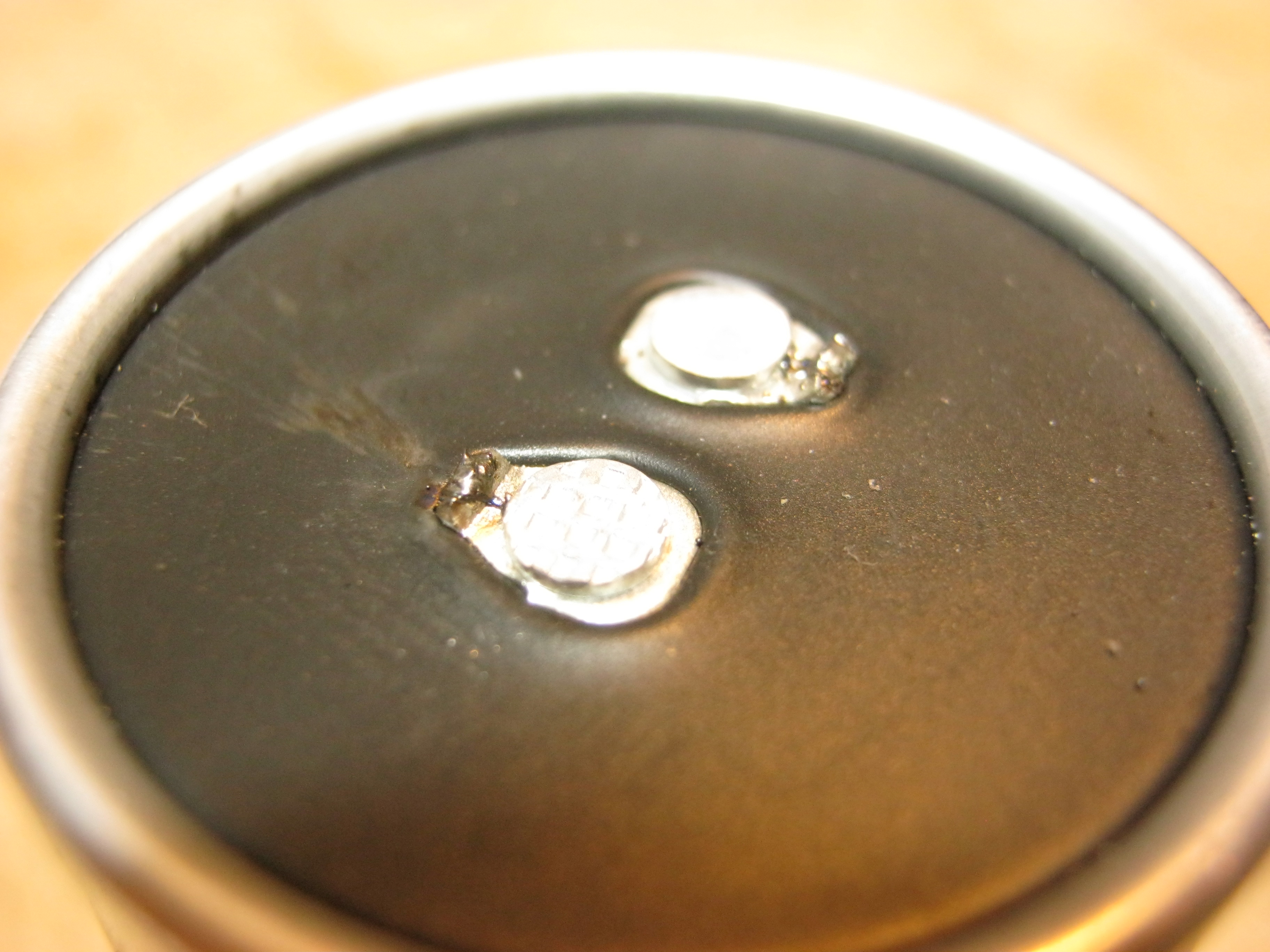

With a cap that size I was expecting to see a "bursting disc" type vent in the end with the terminals, usually a thing rubber membrane about 3 or 4mm diameter.
What happened to the terminals on the cap?
It looks as if they have had some kind of high current event and vaporised!
I have never seen that before.
Tricky... Some leads are outer plated with a copper element core, or as such. It would take some current to vaporize a lead as large as the side burst cap. Only thing I can find familiar is the leads to newer components that have that tin or other outer coatings, the copper core if any would burn up whilst the plating will vaporize leaving some residue on the board.
Those leads do not appear to have a core material resulting in better strength and current handling. Looks a main filter cap leaded capacitor.
:Edit 2 :
Yes - it seems the leads have been blown out by a large current. I'm guessing that this cap went short and then the others in parallel discharged through it. I've never seen it before either!
I've just chopped a lead off one of the surviving caps and it's quite hard - aluminium I think? Doesn't look like copper.

For reference, at there's no scale, the component pictured is 70x35mm.

Thought process, most thought of, a spike resulting in a capacitor fault resulting in a load draw, heating, ripple added resulting the draw, then an eventual burst that freed the cap whilst the leads were molten?
Would the damaged cap be closer to the power source or furthest? It might have been caught in the middle of a stored effort (other caps) and the driven supply. If it were closer then a power spike could have started that if no other components show to be the resulting cause or damaged themselves.
