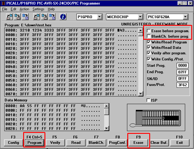

I have had the same problem with Picallw too. Try this, also free:
Following the advice of the following, I solved my problem of programming 16F628A using Picallw. Whether it will apply in your case I don't know.
The source of information is from: https://www.dontronics.com/p16pro.html
3-Jan-2004
Gaston Gagnon wrote:
> I don't know about Picall, I use Picallw software.
> To program 16f628a do:
> 1) Leave both "Erase before program" and "BlankCh. before prog."
> unchecked
> 2) Hit the Erase button
> 3) Then press Program button
> That should do it for you.
> Gaston
WOW! yes that did it.
Thank you so very much. Do you know if that works for other "A" version
chips?
N. Crocker
3-Jan-2004
> unchecked
> Gaston
chips?
N. Crocker
I have just done that but it still is not working. If I command it to erase the PIC I see one of the Red LEDs Flashing, and the same applies when programming. But it reports an error still.
For the PSU I am using that of an HP Laser jet printer 24v dc. What else could be the problem.

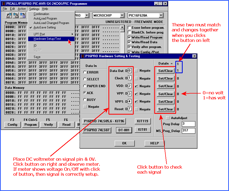

Many things can go wrong with a PIC programmer, most mainly setup problem.
Without a PIC in the socket, confirm that all the signal voltages and control are good.
