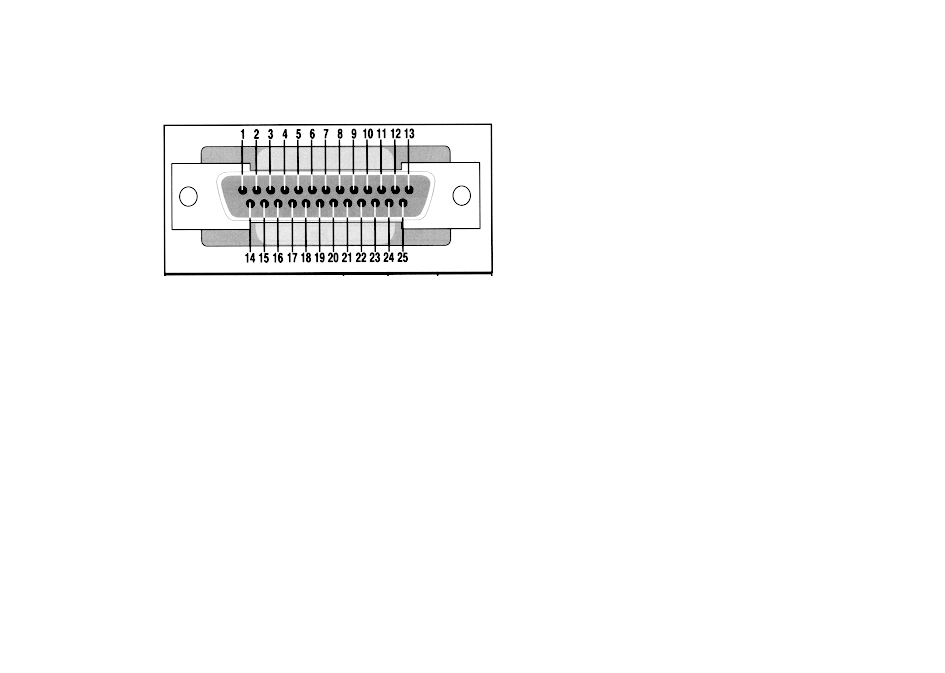

yes now iam on an old computer which has serial port.well i linked to the serial male like the one on jdm's site.so could u show which is the 20.th pin connection?i am only suspicious about that.i checked everything.and now it says again "veryf failed at 0000h!".Chippie how can it read?it can only read the chip because?
here's 25 way pinouts
