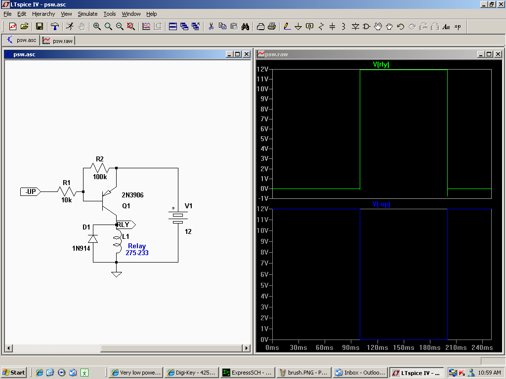

Here is a little circuit with US Radio Shack parts. It's a single pole reed relay good for .5 amps.

I have wired up as per your diagram but the relay is always on ie +12V at RLY. It seems the 12V is getting through the transistor what ever the state of the sensor.
Is the emitter of the transistor tied to +12V? Is the collector of the transistor tied to the relay coil? That should be a PNP transistor, not an NPN.

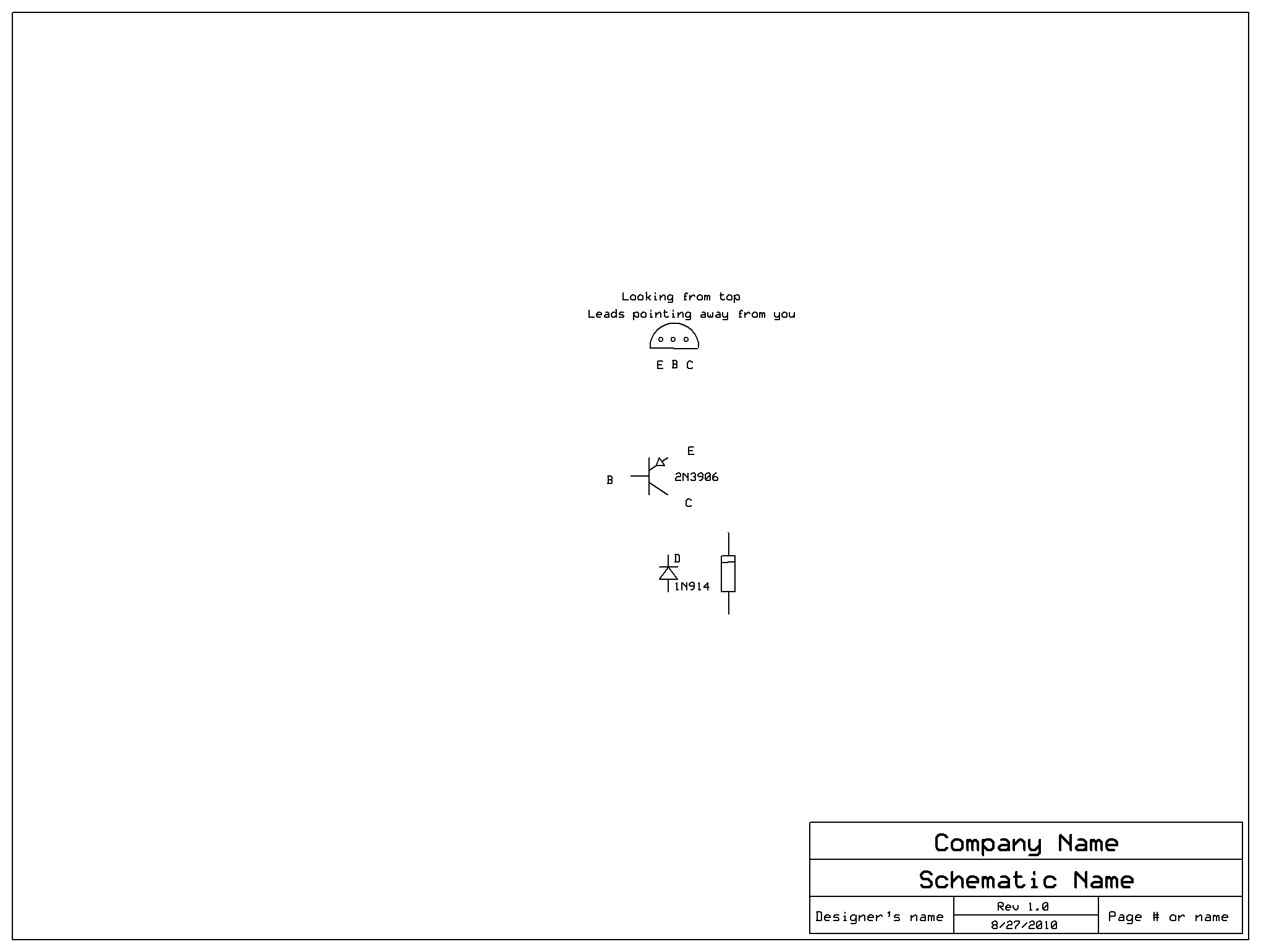

Just to check things out, if you disconnect the sensor the transistor should be off and so should the relay. Attached is a picture of the transistor and how it should be hooked up. Is it a 2N3906?

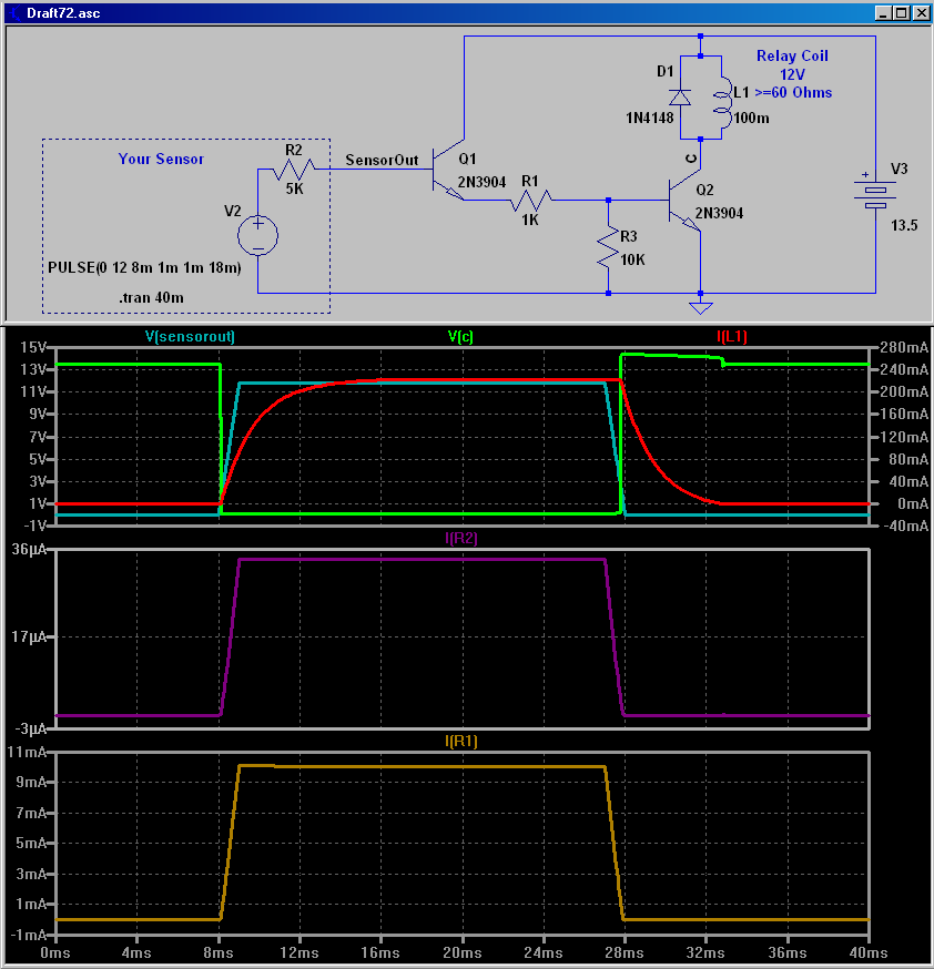

Ok, if you were able to light an LED connected between sensor out and sensor ground, with no current limiting resistor, that says that your sensor is capable of sourcing ~0.1 to 2mA from an open circuit voltage of 12V. Since the tractor's voltage bus is more positive than 12V (~13.5V), Ron's High-side switch is not a good idea. Here is what I would try:
Note that this circuit (modified Darlington) only draws 35uA from the sensor. I am modeling a 12V relay with 60 Ohm coil, which is one of the cheap automotive kind.
