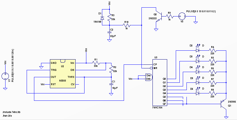

Hi guys i am very new to all this and want a simple circuit that will replicate the starting lights of a formula 1 race for my sons scalextric. So i have 5 led's and a 1.5V battery. I know how to connect these even with a resistor ! but thats about it. For those of you not aware of the F1 start, I require the lights to come on in sequence at 1 second intervals and stay on until the fifth light is lit when this is lit i then need them to all go out ideally with a random pause between 1 and 3 seconds but if thats too tricky for me then just a standard 1 second interval will be fine. The other thing is that i would like this to be cheap, at the moment my parts cost under 50p I don't want to be buying £20 parts! Also if there is something premade i can just wire into the system that would be great. The other issue i may have is that i don't fully understand circuit diagrams, i'm fine with basic electrics but not electronics !. I you could point me in the right direction for simple explanations that would be great.

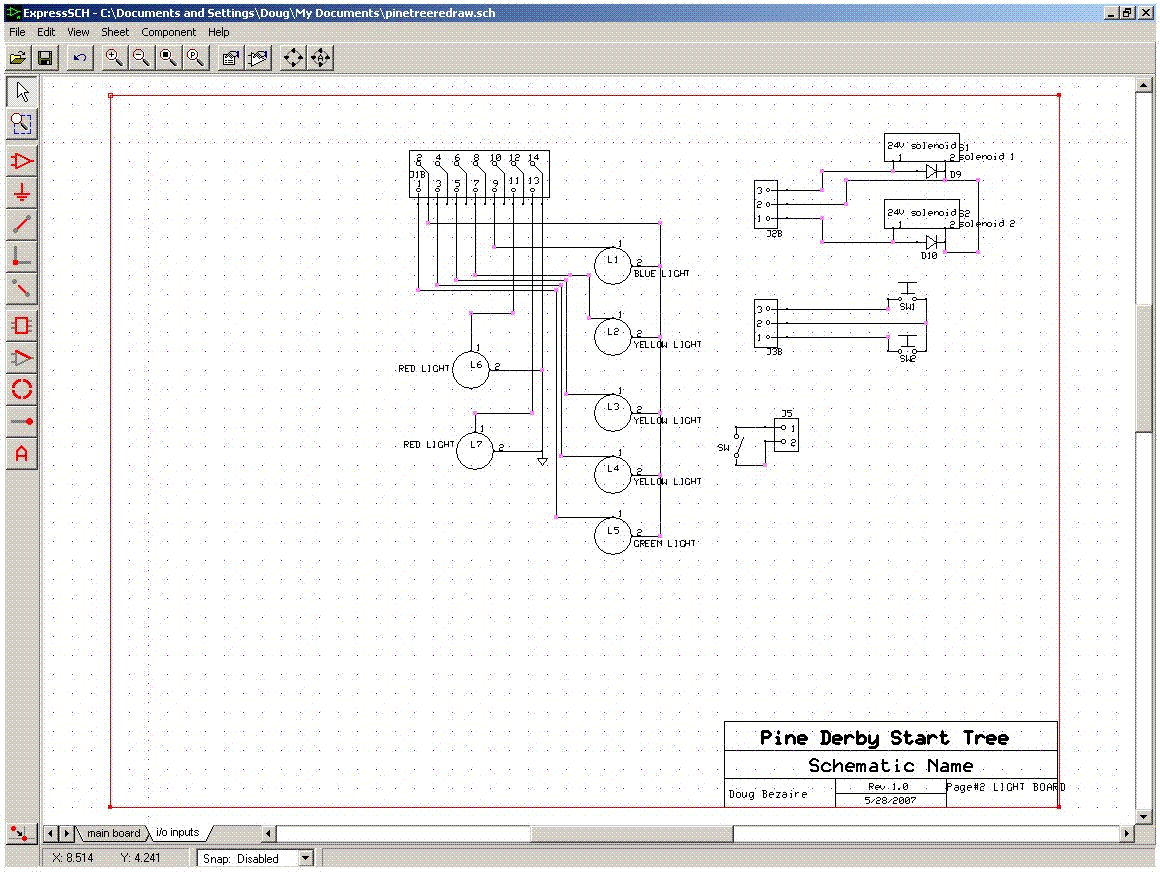

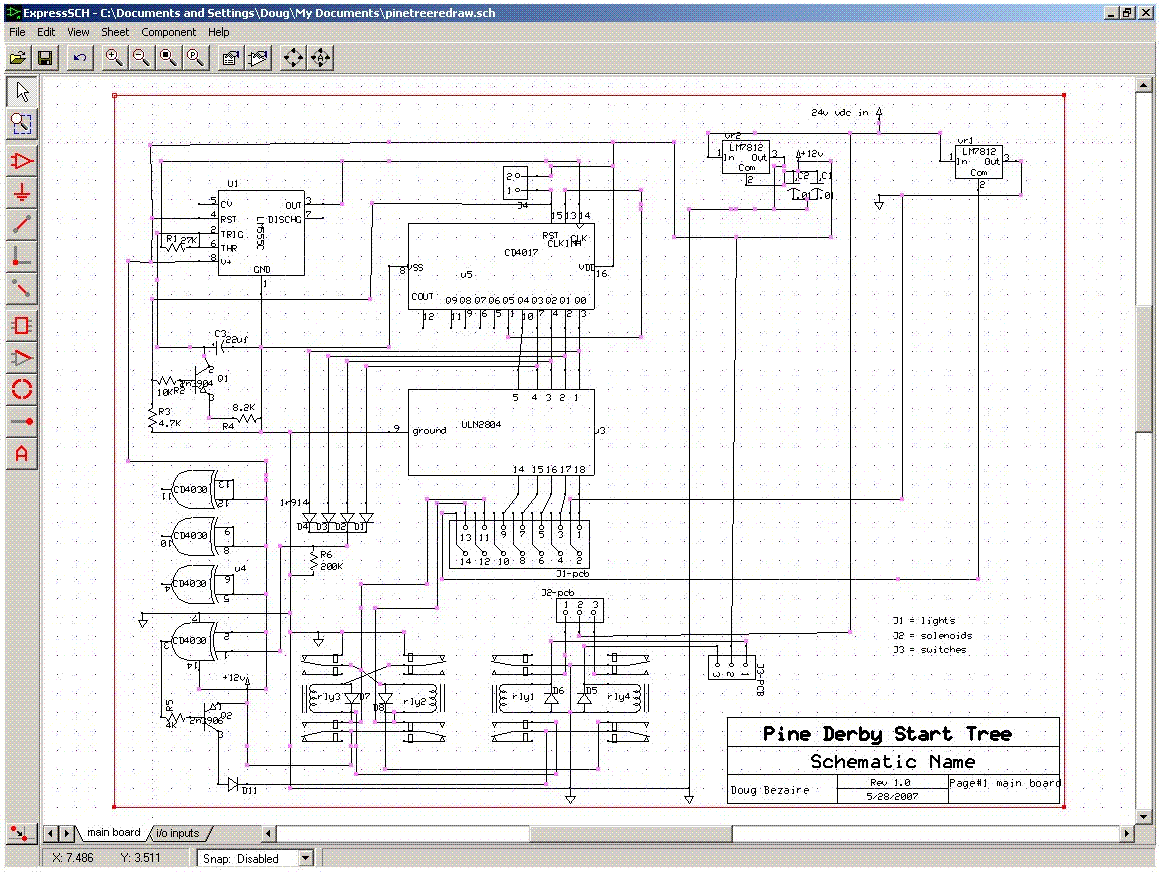

a description of unit I built
I built a drag race start tree that has 3 yellow lights that are 1 second apart then if the "driver" leaves to soon a red light comes on.
very simple circuit built around a 4017 decade timer.
a 4017 decade counter, some flip flop ics to keep the lights lit.
the power supply needs to be bigger as the leds would be dim if lit at all.

Here is my circuit
this is more than you need as this has 2 24v solnoids that release pinewood derby cars.
two rows of lamps not leds.
If one "driver" pushes his release button BEFORE the green light then that lane gets a red light.
the blue lights are stage or get ready to go.
a third person presses a button and the lights proceed to sequence down -yellow, yellow, yellow, green
after the race a reset button is depressed and you start all over.
hope this helps or gets you started

It does not use a 1.5V battery. A red LED needs at least 2V and the circuit needs more.

A 555 can help do what you want, but it can't do it alone. And as audioguru noted you won't do it on 1.5V either (at least, not too easily).
I've attached a fairly simple idea I had, which just uses a 555 to generate a 1-second clock pulse which drives a shift register, which in turn drives some LEDs. If you want to use ultrabright LEDs or incandescent lamps then you should drive them via transistors instead of directly from the 74HC164.
Once power is switched on, there is a short delay after which LEDs D2 through D6 light up at one-second increments. After the 5th LED lights up, all stay on until 1 to 3 seconds have passed depending on whether output Q6, Q7, or Q8 is connected to the base of transistor Q1. After that, all the LEDs turn off until the reset switch is pressed.
Transistor Q2, resistor R9, and voltage source V2 are just there to simulate a reset switch and should not be included if this were built. The switch would be a "momentary normally-open" switch wired where Q2's emitter and collector are. Pressing it starts the countup running again (after a short delay).
There are sadly no solenoid drivers nor false-start alarms; it's cheap and cheerful. :) Just another way to do it.

That looks TOOOO easy lol
I was going to look for a shift register that would keep the leds lit.
the 74164 ?? need to see a data sheet.
would not be too hard to add a false start etc??

I just figured that if you keep feeding 1s to a serial-in, parallel-out shift register, it would count [1,3,7,15,..,n], thereby keeping previous LEDs lit just because the proper bits would be high.
