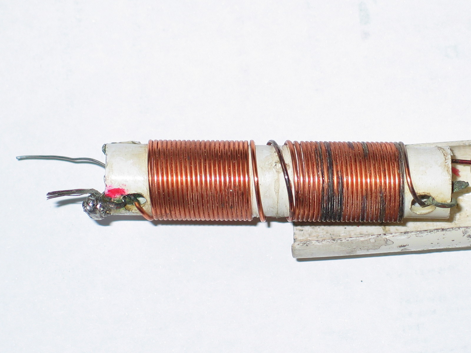

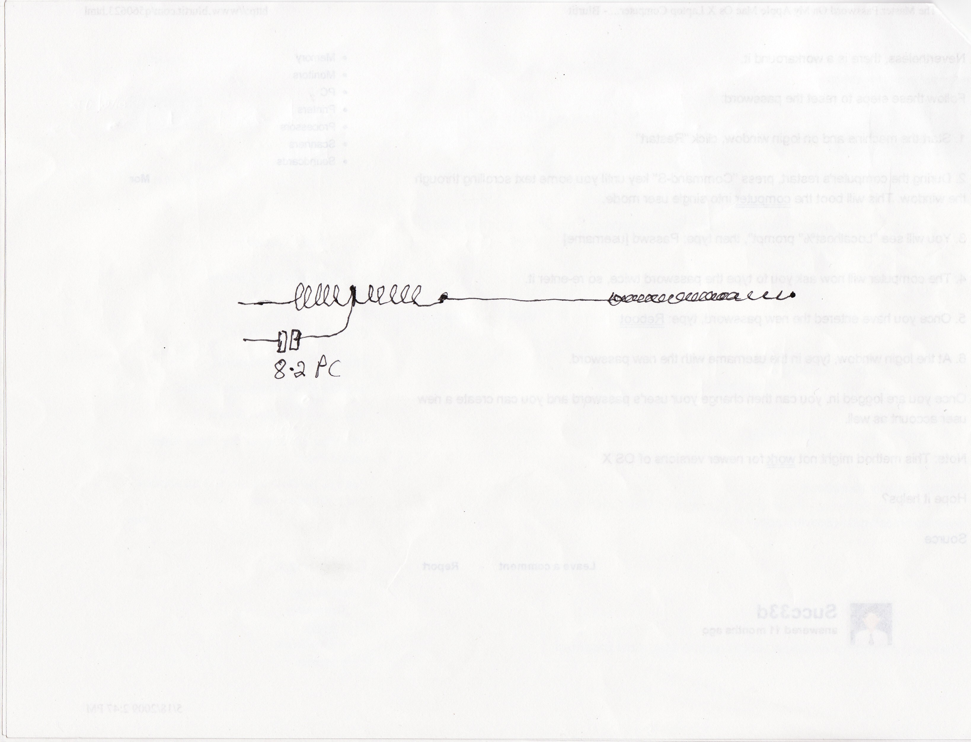

I have a Vhf Marine radio aerial and the Coax is broken from the aerial
Can you advise me where the Screaning wire is soldered to on the aerial and the inner wire
I will supply a Digram of the aerial that also has a 2.8 pf Ceramic Disc Cpacitore

I don't follow your drawing at all. What kind of antenna do you have? Any chance you can post a picture of it?
The drawing IS the aerial, looks like a based loaded whip to me, but I've never seen anything with a capacitor on it like that.

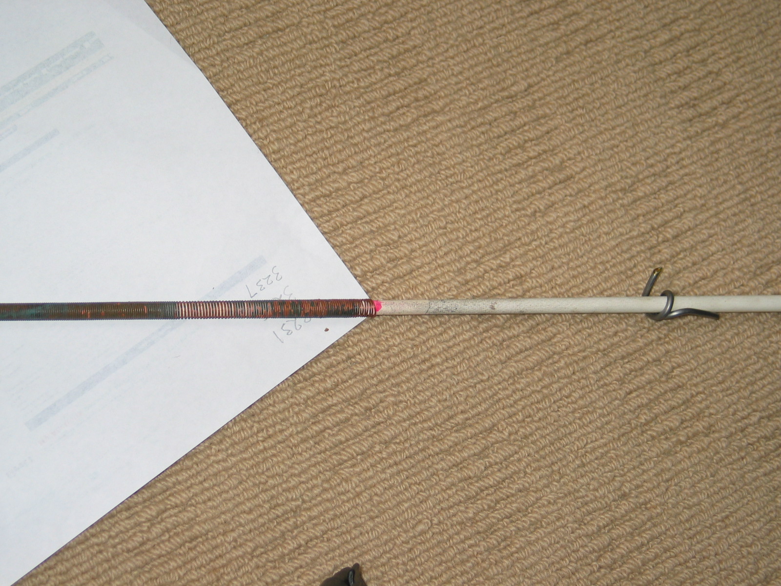

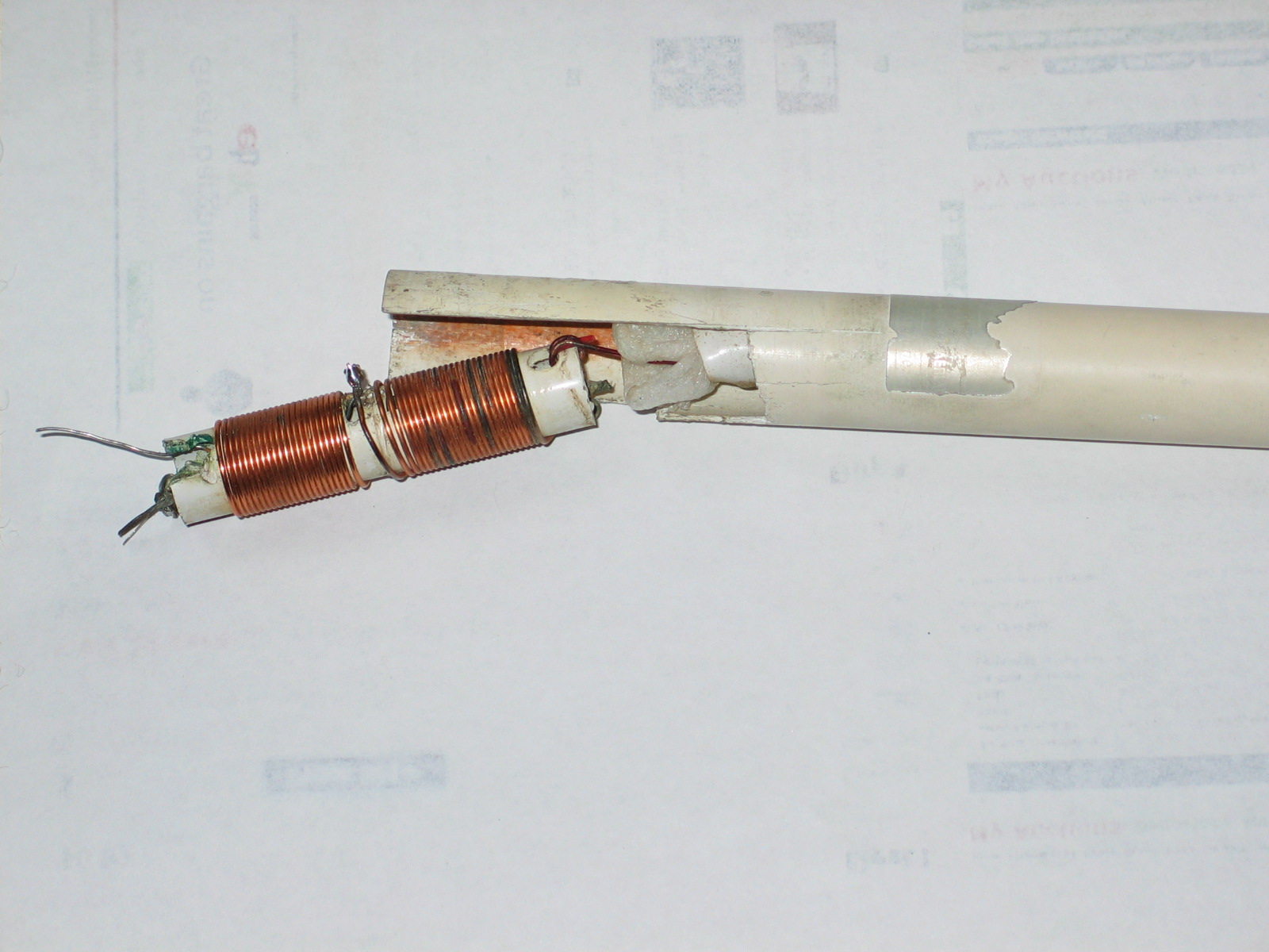

I have attached a photo of the aerial which is 2.3 M in length
The small wire in the photo is the cap which goes to a center tapping of the windings and the other wire is at the start if the winding.
The wirer at the end of the winding goes up the aerial and comes out at the base of the winding at the top as shown in the photo.
The wirer at the corner of the paper in the photo which also has red texture on this area is where the wirer comes out of of the aerial which continues up the aerial.
With regards the coax, where dos the screen wire solder to and where dos the center of the coax solder to in relation to the capacitor.
Thank you greg

I'm thinking a shunt-fed 5/8λ or 3/4λ like is on my boat. AFAIK, the center conductor of the coax attaches to the capacitor, and shield of the coax attaches to the bottom end of the coil. Try it that way, and then use a VHF SWR meter to check it in the marine band.

After seeing those pics I'd recommend a new one, all those green turns on the larger picture are probably shorted together, at the very least the wire needs to be replaced.
I find it VERY strange that you have SO MANY turns for a VHF antenna !!!!
That looks much more like a CB antenna (althrough a 8.2pF cap seems nore suited to a VHF aerial !!!)
