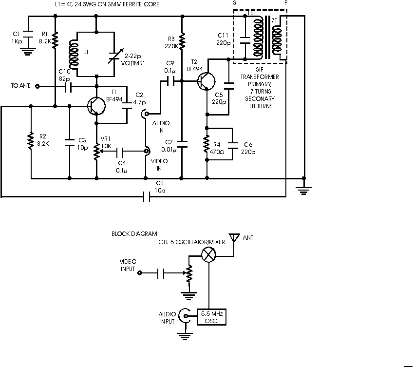

i dont understand sif transformer

The block diagram makes it clear, it's a 5.5MHz FM modulated oscillator, to generate the intercarrier sound. You don't have your location listed, but you should make sure that 5.5MHz is what your country uses!.

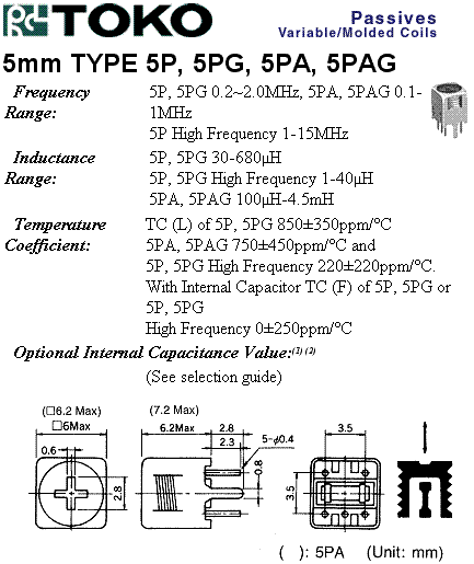

SIF = Sound Intermediate Frequency. This transformer commonly used in TV sound systems.
