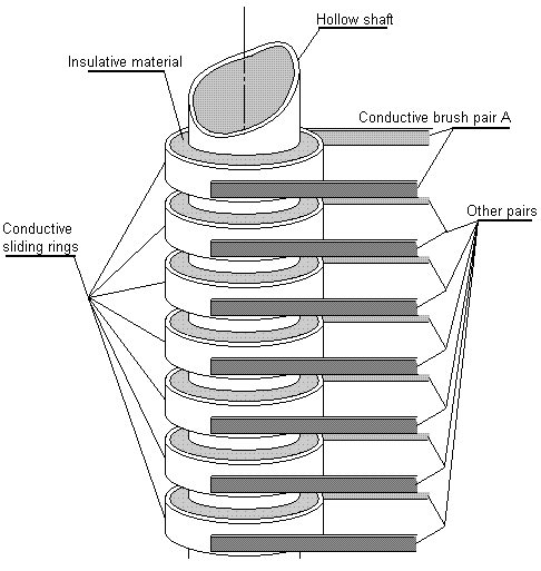

What do you mean by antenna?A wireless transmission or some sort of sliding contactor?Three video channels make a great amount of data stream,I think a parallel data transfer is inevitable.There's no time for encoding and decoding the video singal because of the mechanical structure,which makes it neccessary to keep the input video signal as simple as possible.I drew a scheme with MSpaint and attached it below.Do you think it will work?Or could please you offer a better solution for multi data line connection?
A hall effect sensor probably won't be fast enough to provide accurate synchronization (that thing will have to spin really fast), but you could use some kind of optical detection. Maybe one or more LED's on the outside, at the top or bottom, with a sensor spinning around on the cylinder. Then you could use a PLL with frequency division to derive a clock.
um...I just searched the web to check the switch hall sensors response.it will respond within one microsecond.A speed of 3600rpm gives a refresh rate of 60fps,which is 21,600 degrees per second.The time lag in response will cause an angular error of less than 0.02 degree,which I think is still tolerable for the horizontal positioning.The diameter of the cylinder is over 4 feet.So the perimeter will measure up to 13 feet.Placing a magnet along the perimeter on the static frame and a switch type hall sensor at the tip of the rotor will provide minimum waveform width when the sensor passes by the magnet.An optical solution could provide better accuracy,but I would choose wider gap between the emitter and the sensor for the opaque tip to go throung.Because mechanical variation may deform the structure to make the tip hit the optical unit.
However the PLL method is cool.When the horizontal resolution is Two's power,this hardware angular divider is perfect for saving CPU labour.

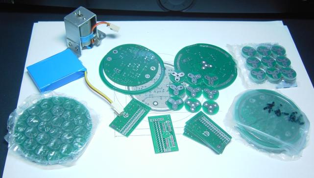

My boards arrived.I took a pic of them together with my motor and Li+.More to come after some soldering :wink:

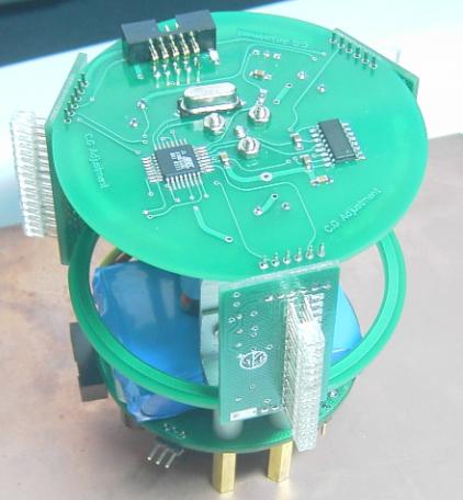

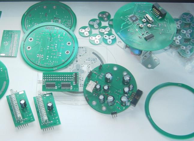

I have finished soldering part of the system and I took pictures of the boards.The critical issue is to balance the rotor.It's really difficult for me,especially when I'm building such a thing for the first time.Three arcs of solder plate areas were drawn when I was designing the rotor hub.By attaching excessive solder,I can adjust the C.G as close to the geometric center as possible.It's an electronic device after all.Assigning weight evenly through the whole cylider in the designing phase is extremely difficult.And it's impossible to make a rotor of absolute symmetry around its axis.
There're a few other problems that I have to resolve.I will get rid of them one by one.Here are two pics I just took:
