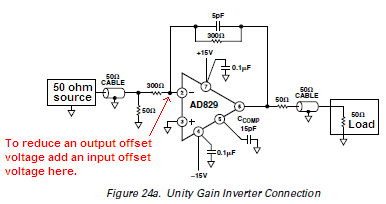

Dear All,
I hav some video data and need to invert the signal. I hav a video data -2vpp and need to invert this data to 2vpp. Can anybody suggest me some good video amplifiers which can do the job. I hav some nosie along with -2vpp and need to retain the noise and after inverting the signal
Circuit diagram also appreciated.

Thanks For the reply,
Mine is raw video from a radar, I was trying to use AD829 from analog Devices. I was able to invert it buy feeding the ip to inverting terminal. But there is a dc shift of abt 1.0 to 1.5v.
If your signal has a negative voltage then the output will be a positive voltage. Add an input offset voltage (through a resistor) to reduce the output offset voltage.
Thanks fr reply. But i had rigged up in the same as u had sent ..but no luck. And more thing is my waveform i.e rise time is also not good.
I want circuit ver i can vary the dc offset and gain separately using different pots. Here in my circuit both gain n offset are varying ven i vary the pot connected at feedback resistor
