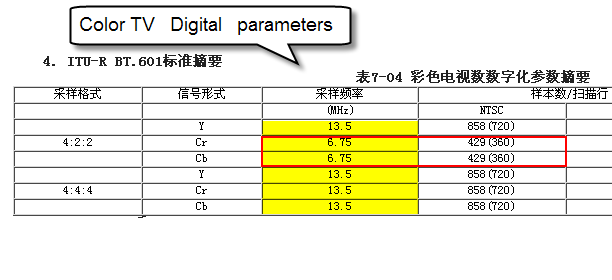

over twisted pair? are you kidding? Video and Imaging - Video Encoders / Decoders - TVP5151 - TI.com 13.5MHz pixel rate 2 9 bit words per pixel for a data rate of 243MBPs
Color TV Digital parameters

Sampling of NTSC must be exactly locked to the subcarrier, and the lower the sampling rate the more critical this becomes. Any drift will make rainbows. Sampling at 3.017x the chroma frequency will only give you psychedelics.
I think you'll find it cheaper to demodulate the chroma and encode it YCbCr.
