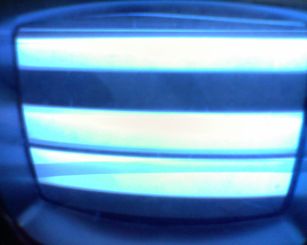

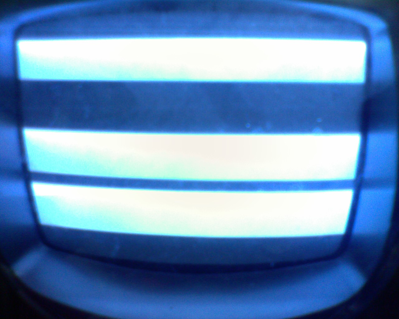

here is a pic of image on my tv

Well, from the schematic, the video polarity is correct for the U.S. (negative going sync tip makes the video amplitude greater), but your monitor is not in sync. Could it be that:
1. You are not in the U.S.? (as an example in the U.K., the sync tip corresponds to the lowest amplitude of the carrier).
2. The monitor and camera are not basically compatible (different line rates -do you know they are compatible?)?
3. You need to adjust the horizontal hold on the monitor? Instead of connecting the 10k from the base of the video modulator transistor to +9V, try connecting it to the base of the RF amplifier transistor. This is supposed to be a Gilbert Multiplier, in which a few hundred millivolts difference in base voltage should be all that's required to obtain 100% modulation.
4. That you need some bias on the video modulation transitor?
By the way, this schematic is drawn "upside down", making it really difficult to read. Maybe it was done this way on purpose.

By the way, in the photographs of the tv screen, I think I can spot the vertical blanking,but no vertical sync. And it would appear that if there is horizontal blanking, that the horizonal is locked.
It could be that the vertical sync is not visible because it is clipped of or blanked inside the tv set, in which case, the sync pulse may be there, but not visible.
Quite puzzling.

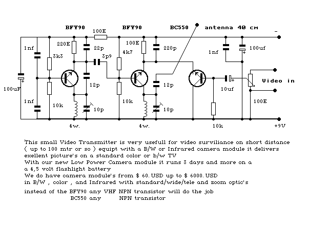

actually,i built a circuit. but it is a simple one transistor circuit.it worked for me.but the quality is poor. please take a look at it. any chance of modifying the present circuit to work like this?i chose the second circuit,because it has different stages and quality and range will be more.but,its not working.please help

The differences between the transmitter that works and the complicated circuit is that the complicated circuit has a buffered RF oscillator a buffer for the video signal.
I think the main advantage of the more complicated circuit (without deep analysis) is that the output power is likely to be a little higher and have a less frequency modulation in the signal. The video buffer transistor (which I referred to in previous posts at the video modulation transistor) adds a little temperature stability to the modulation, but perhaps more importantly, may (if my guess is right) diode clamp the blacks so that the black level doesn't sift around as scene content changes.
I am reluctant to try a design by "remote control" over the web and not having access to PAL equipment, I am not able to take on this as a design task.
Most likely, your best course is to assure that you have built the circuit according to the schematic and then to continue to experiment with the bias and video level adjustment. Alternatively, look for another design on the web.
