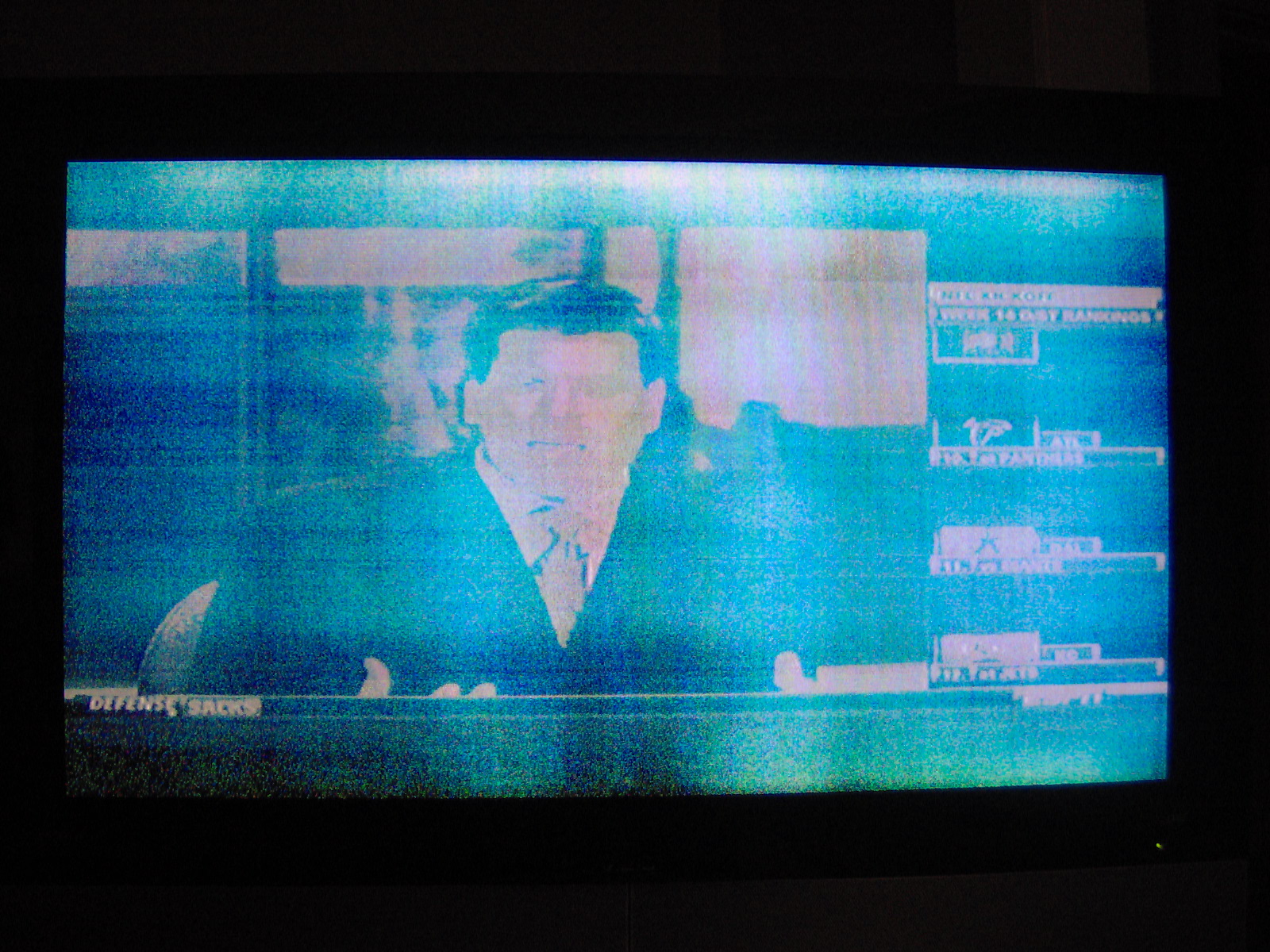

So any thoughts on what direction to take this? Don't have a scope handy to test ripple or waveforms. Here's a pic of the startup condition.

Only thing I can suggest is a freezer spray to try to recreate the "cold" picture.
I would suggest regulation on the signal board looks poor for some reason, however I got caught out with one last year that looked similar, turned out to be the T-Con board.

Good idea on the freezer spray, hadn't thought of that. If I shut off the set after it has warmed up then there are flashing pixels in the white areas. So do you apply spray while the set is powered?, and where?, the ipm module heat sinks, Y driver fets, whole boards ....?

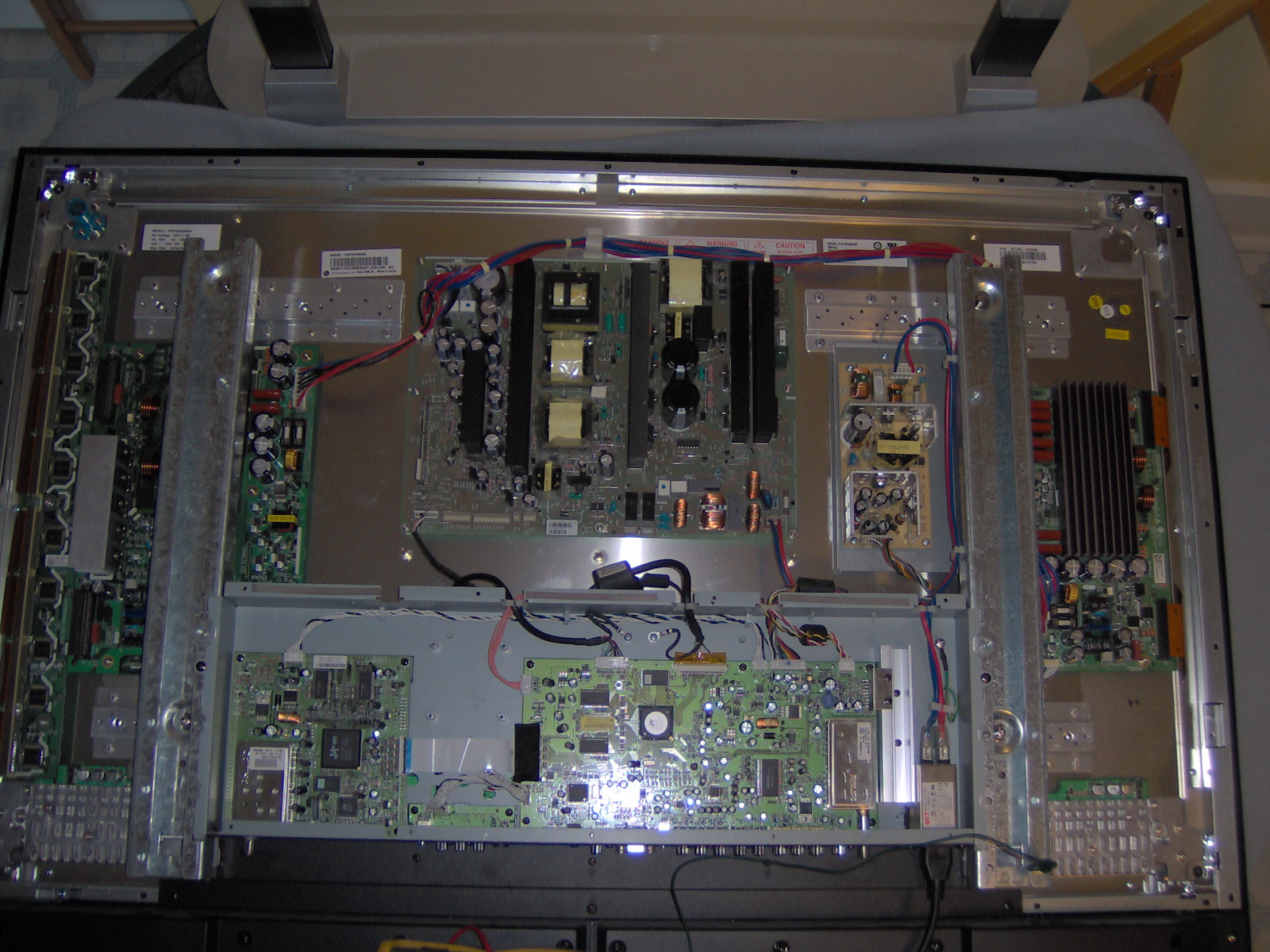

So the signal board meaning the control board? The control board is underneath the tray holding the tuner (small board) and main board (large board) in the bottom center of the pic, kind of hard to diagnose as cables have to come off to get to it.
Even after the tv warms, up there seems to be some subtle horizontal defects. So if the freezer spray doesn't isolate the Ysus and Ydriver boards, then the control board makes sense.

Yup, the T-Con is usually buried under all the metalwork and bolted right to the back of the screen :)

The lasting picture defects could be a Sus board adjustment out of wack, or one of the IPM modules faulty or back to the control board again. The only real way to tell if it's an adjustment would be to hook up a scope and make sure all trimmers are correctly set, or by substitution. What I sometimes do to save time, and money if I'm not on the problem within 40mins, is just buy in a service kit. It comes as both Sus boards and a control board. I will then sell on the old working boards on the 'bay.
