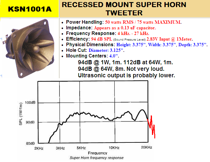

I'm trying to make a small circuit that emits a sound that is annoying
to a barking dog but can't be heard by people (This is for my dog, to
get him to stop barking at the neighbor's children). So I guess I have
a few questions:
1. I've heard that 25-35 KHz is the ideal range to try with dogs, so
what kind of speaker would I need to buy? Should I just look up any
small speaker that has that range and try that? I would obviously have
to see if it had any effect on the dog before I built the rest of the
circuit, so it would have to have a range of around 30-40 feet and moderately loud.
2. I'm thinking of using a Voice activated switch such as
https://www.electronics-lab.com/projects/sensors/025/index.html . A
dog's bark can be up to 105db I have read. Good idea? bad idea?
Thanks.
The special old Motorola IC has not been made for many years.
A speaker is driven by a power amplifier.
Most speakers have trouble above 5kHz. Many tweeters are very fragile and don't go above 17kHz.
Old guitar speakers had a piezo tweeter that goes up to 20kHz and maybe higher. The piezo tweeters are still available.

The sound output circuit should be no problem.
But I like to use the barking as a trigger. Therefore I like to get some ideas how to analyze an incoming sound and filter out not-barking noises.

• I have some speakers that give me 100dBa at 25KHz (and go up to 50KHz)
I doubt it. Most speakers barely go to 20kHz. Maybe you have a piezo "whistle".
