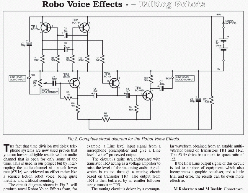

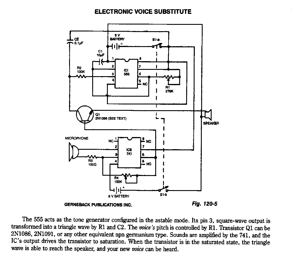

I am designing a 6 channel mixer and I need to add a function that allows me to change the voice of the speaker. Does anyone have a circuit that allows at least to one pre defined sound like for example the most common the chip monk voice? Thanks very much in advanced.
This should produce a ring modulation type effect, making the speaker sound like a robot:
This should achieve a similar effect using one chip (albiet a rather expensive one)
