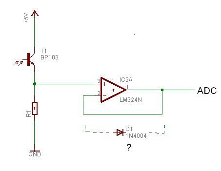

My uni project is a line following robot. Thanks for all your help on the motor circuit before! I've got a problem with the line detection. Ive attached a jpg of my circuit as is which works well. Its about 0.5-0.8v on the black line and 3.6-3.7v on white (lm324 saturation). the problem is i need to limit this to 3.3v to feed into the ADC of the microcontroller. ive tried working the sensor off 3v3 but its no good. I got 3v3 zener diodes aswell but not sure how to use them. Ive googled it but to no avail.
Is there an easy way to do this maybe using diodes in the feedback or the zener somehow?

If you are confident that the opa follower output never exceeds +3.7v
then you can put your diode [not the zener] is series with your output
and connect a 1K0 resistor from the output of the diode to ground.
The voltage at the junction of the diode and resistor will be limited to
approx +3volts.
The anode of the diode goes to the output of the op amp
Refer attachment
Regards
EricG
If its still too high, connect another diode in series

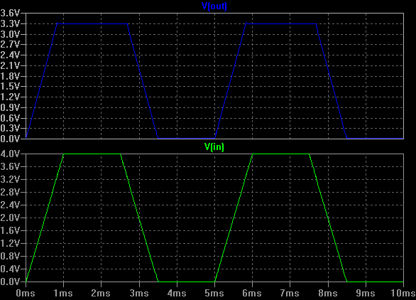

Here's a precision limiter. If your A/D max input is equal to the VCC on the microcontroller, you can use that voltage as the reference input (V3) to the active clamp.
The waveforms speak for themselves.

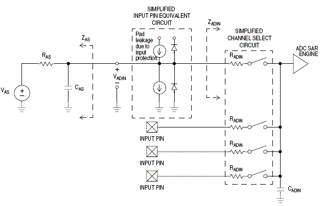

If you ADC has inbuilt protection diodes (as a PIC does) all you need is a simple current limiting resistor - if not?, then just use two resistors as an attenuator!.

Thanks for all your replies.
I tried Erics method first, of the diode in series with output. It works. output is reduced by diode drop and never goes above 3v. tried it with the adc and it works well. Thanks!
This would be good but can you explain how it works? im not sure how to analyse it? I've attached the input circuit for the ADC showing protection diodes (its an HCS08 im using, our project is funded by Freescale so weve got to use their stuff!). Is there anything i should watch using erics circuit? im not sure how the protection works. Here is some of the parameters:

Ron H said:
Here's a precision limiter...
Thanks for doing that aswell. I might build one anyway as a backup/learning exersize.

The protection is simple, Ras limits the current entering the input pin, and the top diode shunts it to the positive supply if it's more than 0.7V higher than the positive supply. The bottom diode does the same if the input goes negative.
