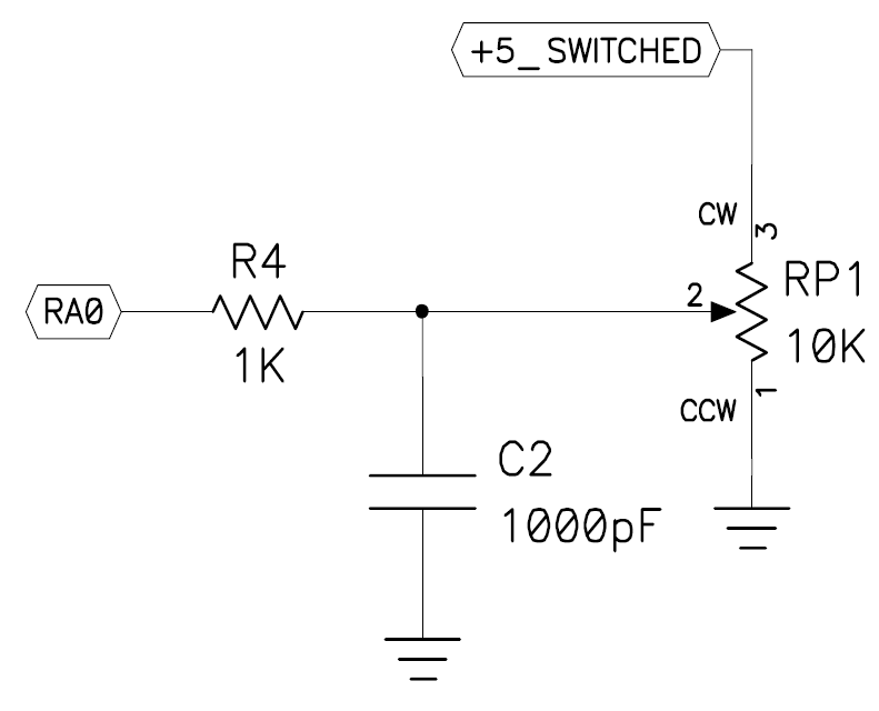

Attached is a schematic showing the voltage divider from the PICkit1 board used to test the analog input by providing varying voltage (I think this is accurate!! Correct me if I'm wrong).
1. Why doesn't the circuit try to flow 5 amps (i=v/r =5V/1ohm =5A) of current to ground when you have RP1 turned all the way down (ie. 1ohm resistance or less)? Isn't this a short circuit?
2. This leads to my second question: When designing circuits (at the moment i'm using a PIC12F675), how much current should you aim to feed into the IO ports when used in analog mode? For example, here the resistance between +5V and RA0 is between 1K and 11K which according to Ohm at 5V drop would be between 5mA and 0.5mA. Or isn't this how it's calculated?
3. What about when the port is in digital mode? I think this is called TTL mode - how much current should you feed them? In other words, what size resistor should be used for a switched input? 1K / 4.7K / 10K?? Confused! Pull up, pull down, can somebody please explain!
Thanks,
David :)
I think because it never gets to 1 ohm due to the 1kohm resistor as a voltage divider, I would need to stare at this longer to tell you a real answer :)
The less resistance the better because it allows for a quicker reading time (The internal capacitor gets discharged faster)
Max current on a pin is about 20mA, take this into account when designing your circuit!
Oops - RP1 Clarification
Regarding question 1: I was wrong about RP1 - it always has 10K ohm resistance between pins 1 and 3. The varying resistance is tapped off at pin 2. So presumably there is always a current draw of 0.5mA between +5V and Gnd. So it never gets to a short circuit.

The 1 k resistor limits you pot to 1 k so the max it can sink is 5mA
You can pull 20 mA from a pin but you shouldn't go over 200 mA total for all ports

When a pin is set to analogue or digital input it will have a very high impedance and the typical current that will flow into/out of the pin will be less than 1uA. In your example the only current that will flow will be through the 10k pot and will follow ohms law. In this case 5/10,000 A (500uA) will flow through the resistor and less than 1uA will flow through the 1k resistor into the pic pin. The 1k resistor and capacitor are not really needed unless you are doing very fast acquisitions and even then it would be rare they would be required.
A typical pullup resistor would be 20k and this is all that is required. The 1-4.7k resistor in Burt's diagram is not needed. And has has already been mentioned it is more normal to have pullups rather than pulldowns
Edit, BTW, the above assumes you are not going to do something silly like making the pin an output.

The 1k resistor is irrelevant. There is no way that when a pin is set to input that 5mA can flow thought it. The only (max) current that will flow through the 1k resistor is 1uA (typically 0.1uA). (inrush on ADC excepted, but still irrelevant).
Whether you should use pullup or pulldown resistors is also pretty irrelevant. It's personal choice or is defined by what you are interfacing. However, with pic chips it is normal to pullup as that is what Microchip built in.
