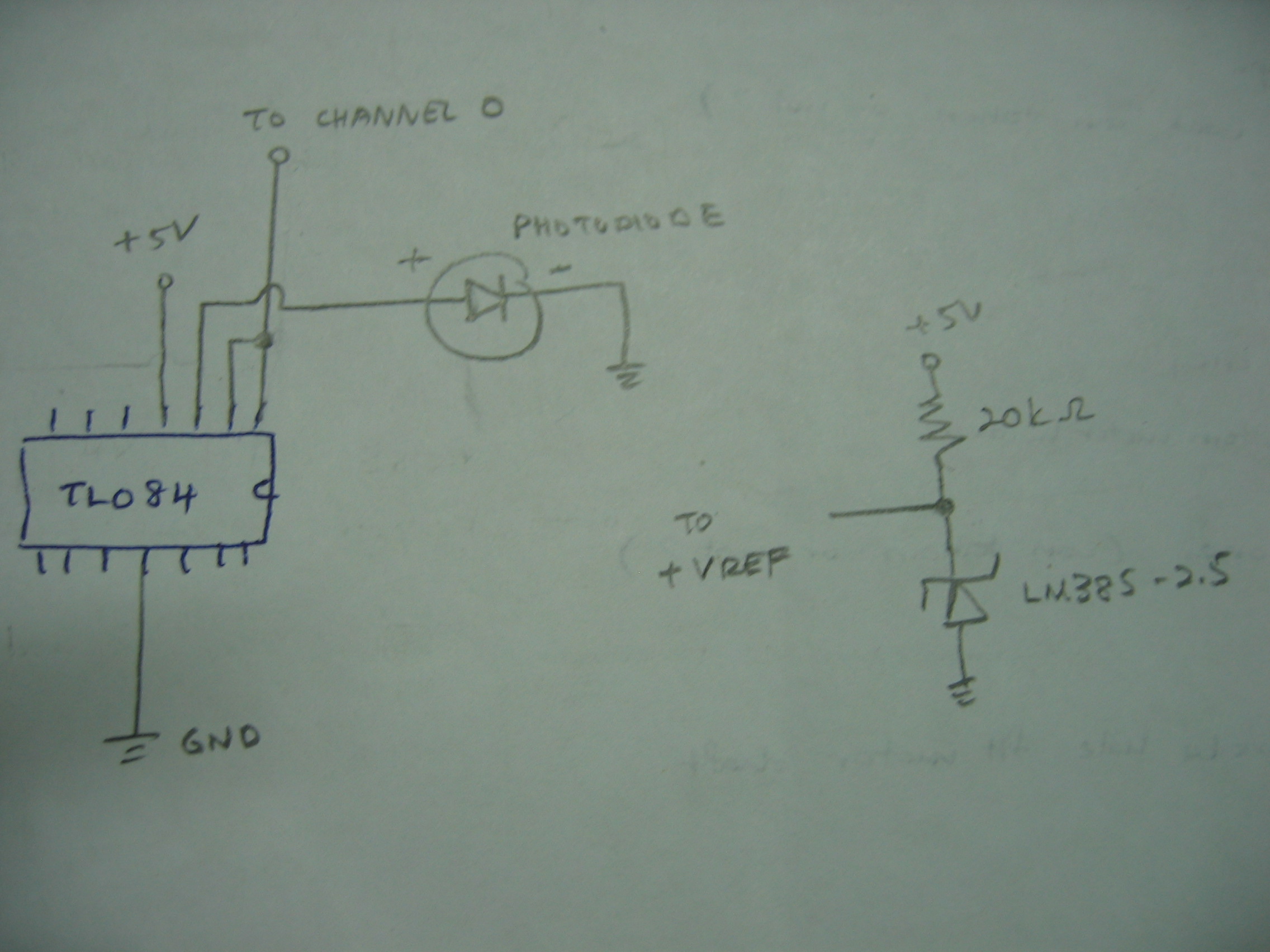

OK, so I bought the TL084 and connected it as a voltage follower. However I cannot get equal voltage at the output if I input the photodiode voltage (around 0.30V). The voltage can follow if I connect 2.5V. I tried simulating it and it seems the output can only follow the input when Vin >= 1.8V, even though the datasheet states Vin 'must never exceed magnitude of supply voltage or 15V, whichever is less' ?
Is the voltage too low ? I have Vcc+ connected to 5V and Vcc- to ground.

Draw the diagram how you've connected it, and post it here, so we can see what you're doing.
Here you go. The right part is just for the 2.5V Vref+.

You don't appear to have it connected at all like an opamp should be, feedback is really pretty essential.

Isnt it just a buffer/voltage follower if I want to have the Vout from the opamp the same as the Vin, with gain 1 ?
The output from a photodiode is absolutely tiny, you need to amplify it, and is current rather than voltage, the link I posted gives the circuit for converting the current to voltage.

OK, i read up a bit on the photodiode amplifiers and those I-V converters.. But with my deadline coming, I decided to just swap the photodiodes with LDRs instead to uncomplicate things. Thanks for all the help anyways, Nigel and all those replied. :D
