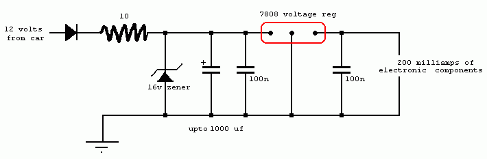

I'm building an automotive circuit.
I had the idea of using a 16 volt zener with an 8 volt voltage reg for my circuit.
Problem is zeners are only 1 watt.
my circuit uses up 200 milliamps (6 watts).
Are there any 6 watt zenners around?
don't I have to use a 6 watt resister with that Zener?
same for the reverse polarity diode. it's only rated at 1 amp.
what amperage rating for the reverse polarity diode do I use?
do I really nead to use the Zener and resister in automotive circuits?

Yes you can get high wattage zeners, they are usually stud mounting, and require fitting on heatsinks. However, you would not usually design a circuit so crudely, a properly designed voltage regulator would only use a small zener, and a power transistor would dissipate the heat.
But your question is far too vague to make any suggestions!.

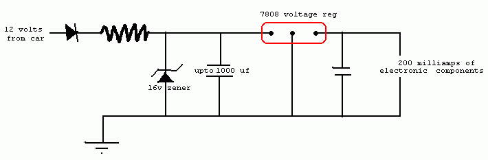

I hope the pic is not crude.
do i really nead the zener for automotive applications?
I would rather do without it.
the electronic components are leds, some cmos chips, 555 times, a few transistors , all consuming 200 milliamps.

The zener and serial resistor not really needed. ( except when some spikes existiert over 16V.) The 7805 require heatsink, or direct mounting on chassis.

For in-car use the zener and resistor is probably a good idea, and would almost certainly be included in any properly designed commercial equipment - it might also include a LC filter on the incoming supply as well?.
The electrical circuit in a car is a VERY noisey place!.
sebi,is that a 10 ohm, 10 watt resistor?
I got a automotive peformance electronic magazine, and nearly all the circuits in it, use a 10 ohm resistor(dont know the wattage), a 1 amp diode, and 16 volt zener(1 watt).

He labelled it 10 ohms, but it rather depends on the current required by the load. The 7805 is rated at 1A maximum, so if the 10 ohm is passing 1A it will drop 10V, which of course means you won't have 5V coming out of the 7805 anymore!.

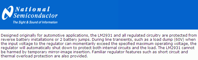

Instead of adding a pile of parts to protect an ordinary regulator, why not use a regulator that is designed to take care of itself and its load in a car?
Here is one that I use all the time. It is a little low-power one but bigger ones are available. As a bonus, it is also low-dropout, so is also excellent to use with a little 9V battery.

Automotive circuits have surge ratings and the voltage in those ratings can go upto +/-150 V for very short time durations

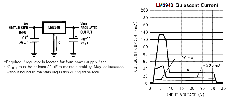

Just found that national makes 1 amp ones. They are Lm2940 series. They come in 5,8,9,10,12,15 volt.
I will most likely use them with my fingers crossed.

The LM2940 will work fine in a car. Notice that a minimum value of 22uF is required as an output cap, like most low-dropout regulators.
It is interesting that its quiescent current spikes as it approaching a low-dropout condition with a heavy load, 'cause I guess its poor transistors are starving for some voltage. :lol:

Audioguru, they only specifying a .47 Uf cap on the input of the LM2940?
Can I put a bigger cap then the .47 uf one there, or beside it?

The capacitor is basically used to maintain the voltage constant when there are transistions in the voltage.
In this kind of regulator the output capacitors determine the load and line regulation characteristics. the recomended minimum value is to get the performance as per specified in datasheet.
The input capacitor is basically just to remove transistions from reaching the input of the IC (that is it helps in line regulation) but if you are using a battery source or constant DC source then the making the value of input capacitor high wont make any effect on the circuit.
It will just increase the cost and space on PCB

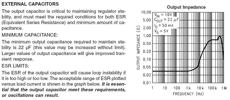

The datasheet says that the 0.47uF input capacitor is needed if the regulator is located far from the power supply filter capacitor (of the rectifier). Like all high gain regulators it keeps the circuit from oscillating. It is best to use it anyway. Of course it still needs a big main filter cap.
The datasheet also says that the minimum value and low ESR of the output capacitor is extremely important over the full temperature range expected to keep the circuit from oscillating. Since its transient response isn't great anyway, it is best to increase its value more than minimum. Look at the curve that shows the output impedance skyrocket up with transients above only 6kHz.
Low-dropout regulators use a common-emitter slow PNP transistor with gain as the pass device. It has a high phase-shift above 6kHz therefore these regulators need the output capacitor for stability.
Ordinary regulators use a common-collector (emitter-follower) fast NPN transistor without gain as the pass device. They don't have much phase-shift. :lol:
