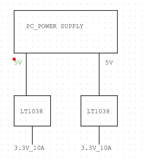

Hi to everybody. I wanted to ask if the circuit below can works or not. I need a precise 3.3 V and a current of 20A. I wanted to use the pc power supply but it is not so precise and stable. So I thought to use to voltage regulator (of 10A each) in parallel like in the circuit below. Can it works?
The pc power supply has dirìfferent 5V output pin, in the schematic above i used 2 of them.
The output voltages of the power supply ICs will be a little different so one will power the load or be overloaded and the one with a slightly lower voltage will do nothing.
Also your circuit is missing the extremely important input and output capacitors and voltage-setting resistors shown on the datasheet of the LT1038. The datasheet shows how to parallel two LT1038 using two feet of wire as resistors.

Your setup will work because when one supply will reach its limit the output voltage will drop a little and the other parallel supply will give the rest of the current you need.
You can not depend on luck for doing this kind of thing. It's hard to figure out the exact output resistance of each regulator, so one may supply more than the other even though it may not be everything. The only way to be sure is to measure, and that could mean over the entire range of temperatures that might be encountered.
Current sharing resistors are a good idea, but again a couple measurements tells all. If you can turn the load current up gradually that would be a good idea too for testing the setup.
It is not important at all that the supplies share equally. There is nothing wrong with one supply giving 10A and the other one 0A, or one gives 10A and the other 5A.
Power supplies don't care about socialism.

Hi there,
Isnt that just a little bit of an over simplification?
You're right about what you said though, that there is nothing wrong with one reg giving 10 amps and the other giving 0 amps, but except for a redundant application we dont put two 10 amp regulators together so that they can supply, well, 10 amps. It would not be right to say that we should try to get 20 amps either, but say at least 18 amps should be reasonable dont you think? Then ideally, we want each one to supply 9 amps, not one 10 amps and the other 8 amps either. That requires some care in the design.
But hey, we are only talking statics here so far and have not even begun to talk about the circuit dynamics. What if one puts out 10 amps and the other 8 amps, and then 100us later they both put out 9 amps, then another 100us later the opposite one puts out 10 amps and the one that was putting out 10 amps now puts out 8 amps? One could go into current limit, then pop out again, then pop back into current limit, etc. That means they oscillate, at least a little. It really depends on their exact internal circuitry and how they start up and react to changing loads and changing line conditions. Can you really say with certainty how all this is going to pan out?
To add to the mystery, every application that involves regulators always has some sort of matching resistances placed somewhere in the circuit to help mitigate the balance in current sharing.

The OP already has a 3.3V 20A PS but he wants linear regulator because he needs better stability for his experiment. He is not developing a commercial power supply.
The LT1038 that he uses can regulate over 14A when the input is 5V.
In theory the chip that gives the higher voltage may give all the 20A, you cannot match 2 chips by any means. In real life and by the specs of the device the output drops at higher temperature, it means that the other chip will come in as soon as the first one gets hot. It is likely that the chips will give similar current regulated by their temperature.
When one chip goes into current limit the output drops and the other chip shares the current.
With the recommended caps by the datasheet there will be no oscillations of any kind.
zahwi's statement is correct and the parallel configuration will work fine.
It is not necessary for both chips to exactly share current, as he quite rightly says.
In view of the currents involved it will be best to have a good layout using thick conductors and a star configuration.
As each chip will be dissipating 17W a substantial heat sink will be required.
Good decoupling will also be required.
