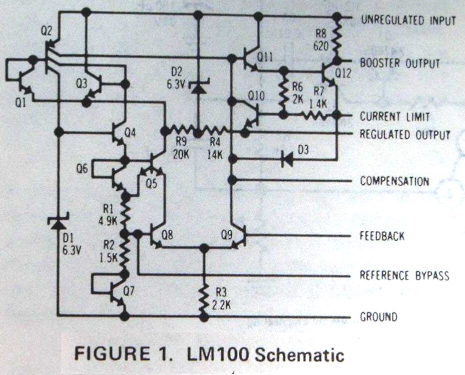

The Internal Schematic of this device, as well as typical applications, Appear in the "1968 National Linear Data Book" (Application AN-8).
I have that data book.
So what do you want?
The schematic of the LM100?
The applications?
Let me know and I can probably post it.

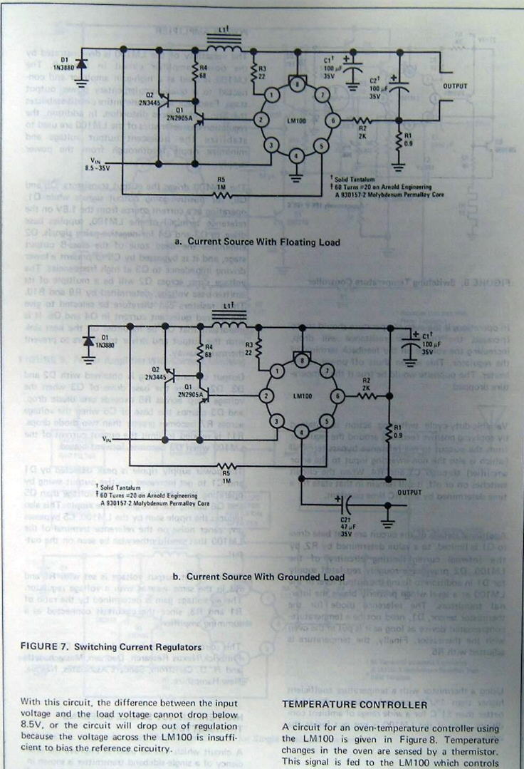

Here is the Schematic and Part of the documentation.

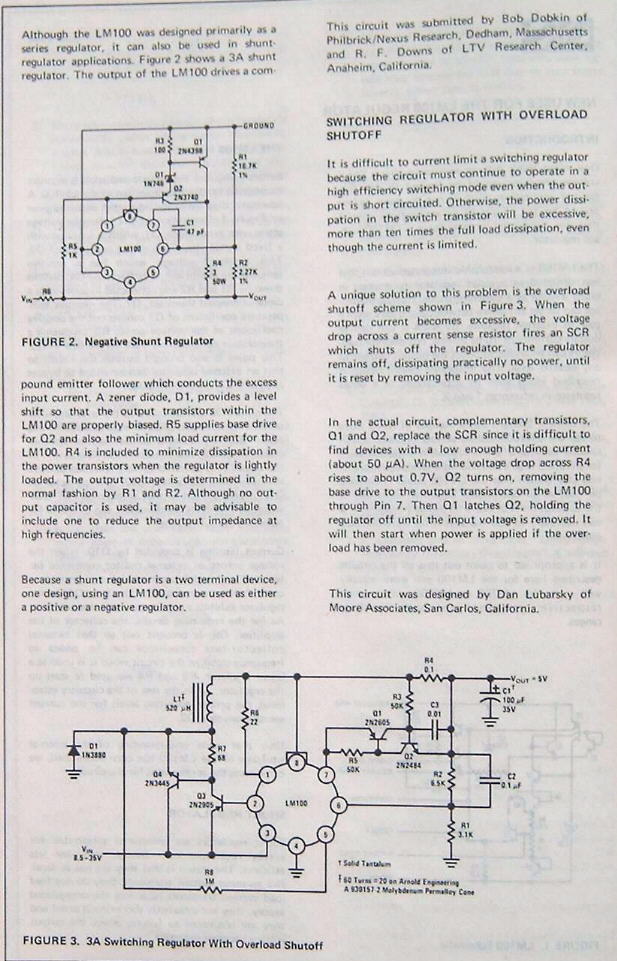

Think I Goofed on the last post, but here is More.
