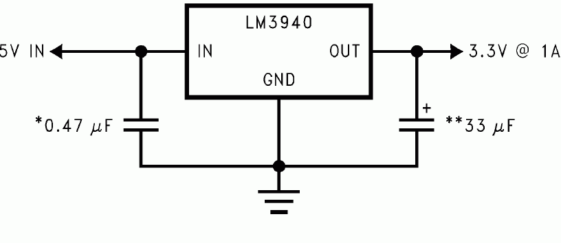

LM3940 will do the trick.
I thought he asked for a 3V regulator. The LM3940 is a 3.3 V regulator, or did I miss something?

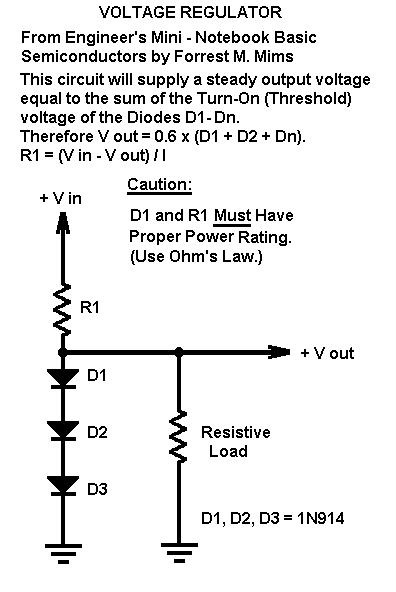

hotwaterwizard said:
Nothing a diode can't fix
A diode would give 2.7 to 2.3V on the output depending on the load which might be too low for it to operate reliably.
I wouldn't worry about it 3.3V is close enough.
I think the wizard meant a schottky diode. The Vf is 0.2V to 0.3V depending on the current.
No I meant Regular Diodes.
Why would you put this on the output of a 3.3 Volt regulator? Or are you saying this will do the whole job of providing 3V from a higher input.
