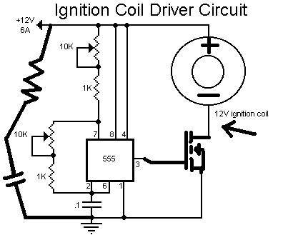

Would the best way to prevent transient voltage spikes when powering on/off a circuit be to add a capacitor between the DC supply and ground? If there's a better solution, I'd appreciate the advice!
I have a 555 timer circuit feeding some 2n3055's which I'm using to make high voltage sparks through ignition coils. I keep frying the 555's and 2n3055's when I turn the circuit on or off when it's tuned to resonance. For my project I'd like to be able to keep it tuned to resonance when I power it on or off.

2N3055 is a transistor for audio amplifiers and linear power supplies. It is actually a terrible choice for an ignition coil driver (trust me, I have LOTS of experience with them).
Look for a power MOSFET in a TO-220 or TO-247 case. Get a high voltage rating - 200V or more should be the minimum. You don't want to snub or limit the di/dt spike on the primary, because it's the inductive kick that is giving you the HV spike on the secondary. Choose a high voltage mosfet that will withstand the inductive kick that will be seen on the primary (500V is a safe choice). I have scoped the drain voltage of a MOSFET used as an ignition coil switch and it frequently is in the 200V range. There are several good choices on Digikey and Mouser; if you want me to pick out a specific one for you I can. Just give me a max price, but remember it is better to buy one or two $10 transistors and never have them blow than to buy a dozen $3 transistors and have to keep replacing them.
For keeping the 555 from frying, I would use an RC snubber across the power/ground rails. You could also use a transient voltage suppressor zener (TVS zener) or a metal oxide varistor (MOV), but a proper RC snubber is more robust and likely cheaper.

This is the circuit I'm using. It's a common schematic I've seen a few places online. The coil I'm using is a low impedance coil (external resistor required). Should I place the resistor between my transistor and the coil or the coil and the power, and if so, how many ohms? For the snubber, would a 100 ohm resistor and a .01uF cap work ok? I'd prefer the snubber to the varistor since I have tons of caps and resistors lying around and I live in the middle of nowhere and it's an hour drive to a radio shack from here! Thanks again to everyone!
I've put an ammeter on the power rail (12v) and I'm pulling 4 amps, plus or minus a fraction of an amp depending on the frequency.

If it's just on off, the cap would not help. You need a snubber. FOr example, an RC snubber plaed across the ignition coil (though I suspect it may also hamper performance which is what Speakerguy is saying). SO I guess the only solution is to get a more rugged transistor.

um... turn the coil around. If your using the schematic shown your firing it the wrong way! wierd as it may sound this helps alot on this circuit.
The primary of the coil is in series with the secondary not parallel as most seem to think.

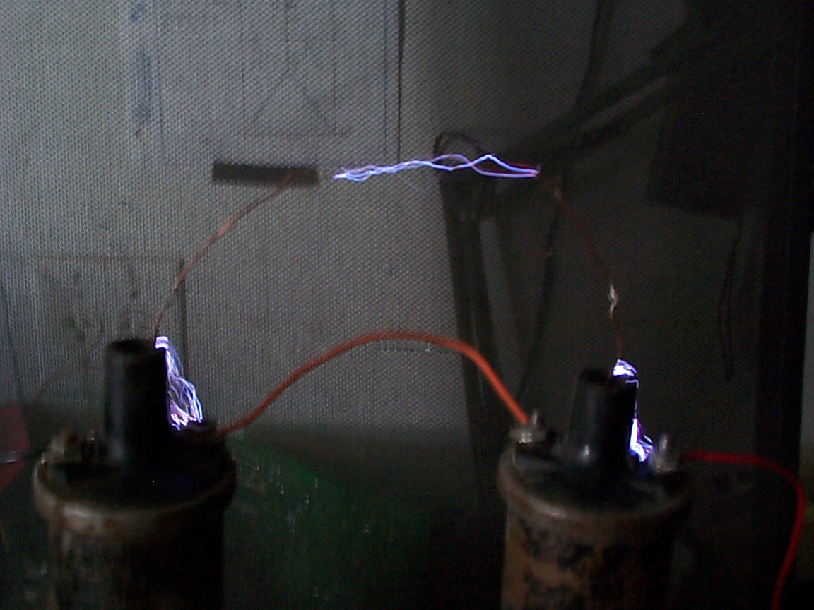

When properly done this circiut can blow sparks right out the top of some coils outputs and back down to the side terminals!
Just like in the picture I posted earlier! Thats one of my spark toys. I am running back to back coils one is forward firing the other is reverse firing. (180 degrees out of phase) I have 6 volt coils with 24 volt sources and no resistors. :eek: the switches are 600 volt 50 amp IGBT's and the circuit is set up for adjustable dwell (Switch ON/OFF time) and frequency! Very tunable and can vary the spark size and intensity greatly!;)
Once you have your sparker set up and working properly feed an audio signal into pin 5 on the 555. If done properly your sparker will sing for you! :D
Here is a fixed schematic of what IMO you should try. I never found that the coils I was playing with needed a resistor, so you might try it without one. In the picture I've changed the 2n3055 to an N-channel FET like I linked to above, corrected the polarity of the ignition coil (that was a HUGE mistake in that picture), and drawn in the snubber. The arrow points to where you will see a large (>100V and maybe a lot more) spike when you turn off the MOSFET. Don't snub this. Snubbing it allows current to flow in the primary and slows the collapse of the magnetic field inside the transformer. The faster the field in the transformer collapses, the higher the voltage you get on the secondary.
Also, tcmtech made a good point. Ignition coils are autotransformers, not your regular type transformers. The primary and secondary coils are the SAME COIL, it's just that the primary is taken from a tap after a small amount of the total turns. They share a common (-) terminal.
