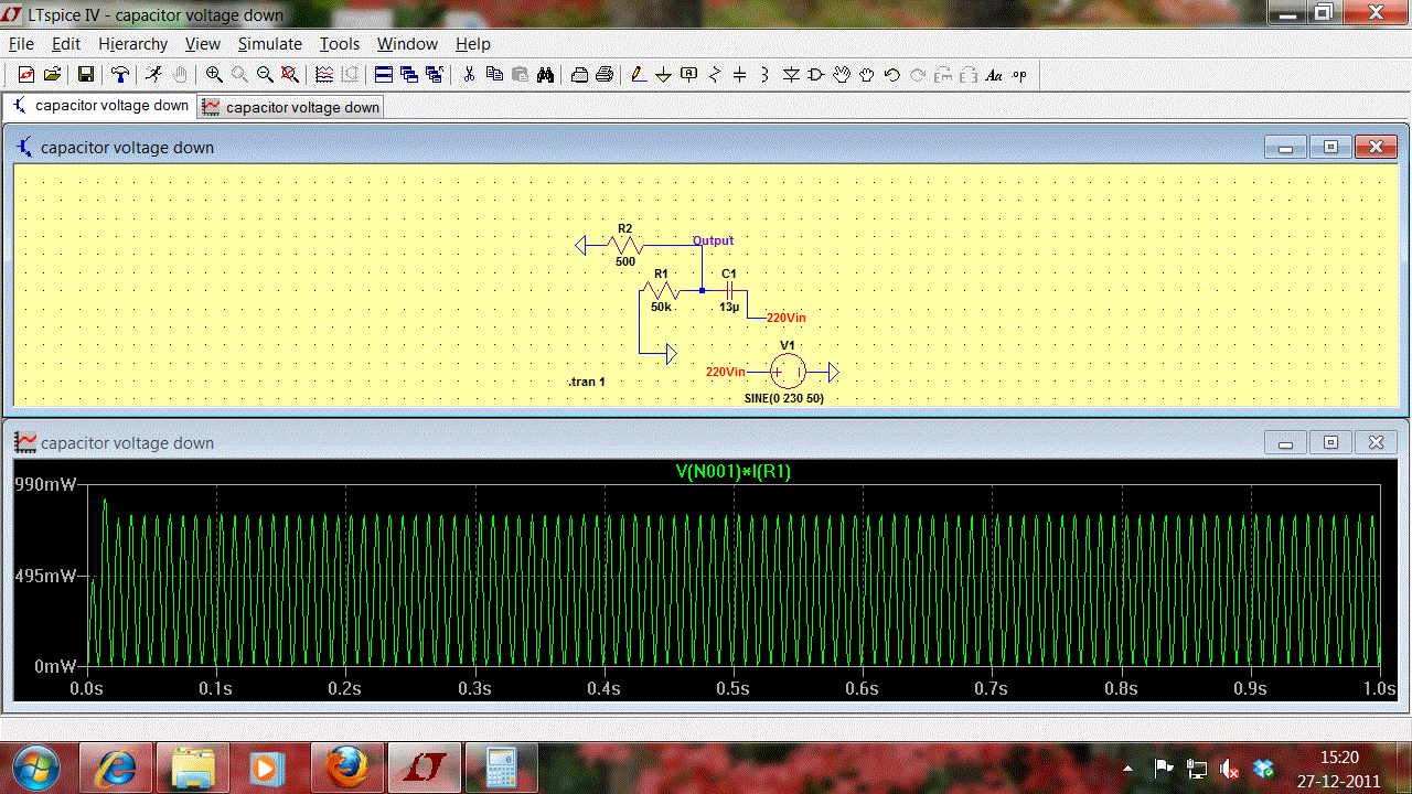

i would like to know why dont we use capacitor to step down Mains voltage in battery charger.
like this i have shown, it dessipites 800mW of power in process.
but circuit is less bulky then Transformer one.

then what about the reactance , it increases with decreasing frequency. i started to decrease my output resistance from 100 to 0.1 ohm but current flowing through it remains to some extent same 1mA to 9mA but voltage wildely varies to 1mV to 1000mV , or is Spice can not simulate real life situation ?

In LTspice when i cut output from the circuit the only thing that happens is voltage output falls, Current oscillation switches from capacitor to 50k resistance, I dont know how to make neutral supply line in LTspice line so i have grounded it.

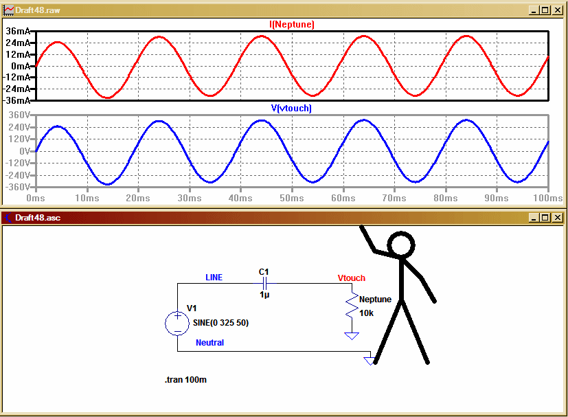

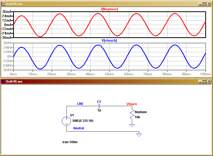

Look at this Sim.!

The danger is simply that the capacitively coupled output is not isolated from the AC mains ground. Thus touching any live wire in such a circuit can generate a dangerous current to earth ground through your body and electrocute you.
A transformer isolated circuit has no path from the mains to earth ground so cannot electrocute you.
You can simulate that with LTspice. If you ground the mains input source to a transformer but not the output, you will see no current between an output resistor and ground. You will with a capacitively coupled circuit.
I have updated Eric's simulation to include Neptune in the picture. Note Neptune is grounded, note Neptune is toast or at least really having a bad day. Note why circuits like this are not a good design practice. There, done.

I did name the resistor in my Sim as 'neptune'!
Your 'flashing' image of neptune deserves an Oscar!..
Hope you have saved a mince pie for your morning coffee...:p
I caught the Neptune 10K along with the current. :)
