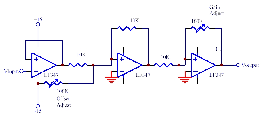

Thanks for the suggestions. Actually i tried the same thing from a book by "jan axelson", below is the diagram of the same thing. But it didn't worked. actually i'm new to op-amps. please explain me in detail. one thing more one of my friend told me a op-amp wouldn't give full linear response? is it true? please help me out, & which op-amp should i use.
First thing that's important to know, that not all OP-AMPs are Rail-to-Rail. That means that their output can't reach GND and (or) VDD level. For example old 1458 or 741 can't do so. This would intact linearity of A2D @ sensing voltages near GND or VDD. Try using LM358 (dual OP-AMP) or LM324 (quad OP-AMP), their output ca swing to GND and to VDD-1.5V.
