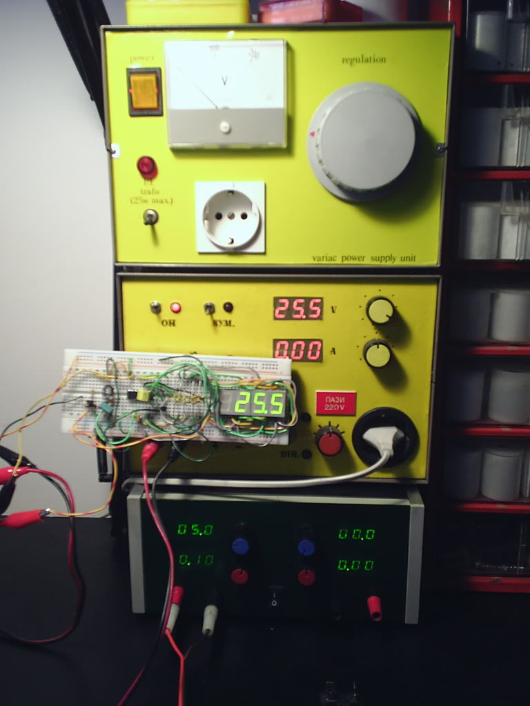

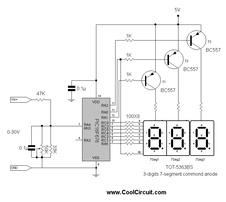

DevilMKD New Member Jan 7, 2010 #3 Hi if the schematic is this then dont build it it doesn't work Here's the correct schematic i have tested it and it work good here can you download the hex file Code: **broken link removed** some pics
