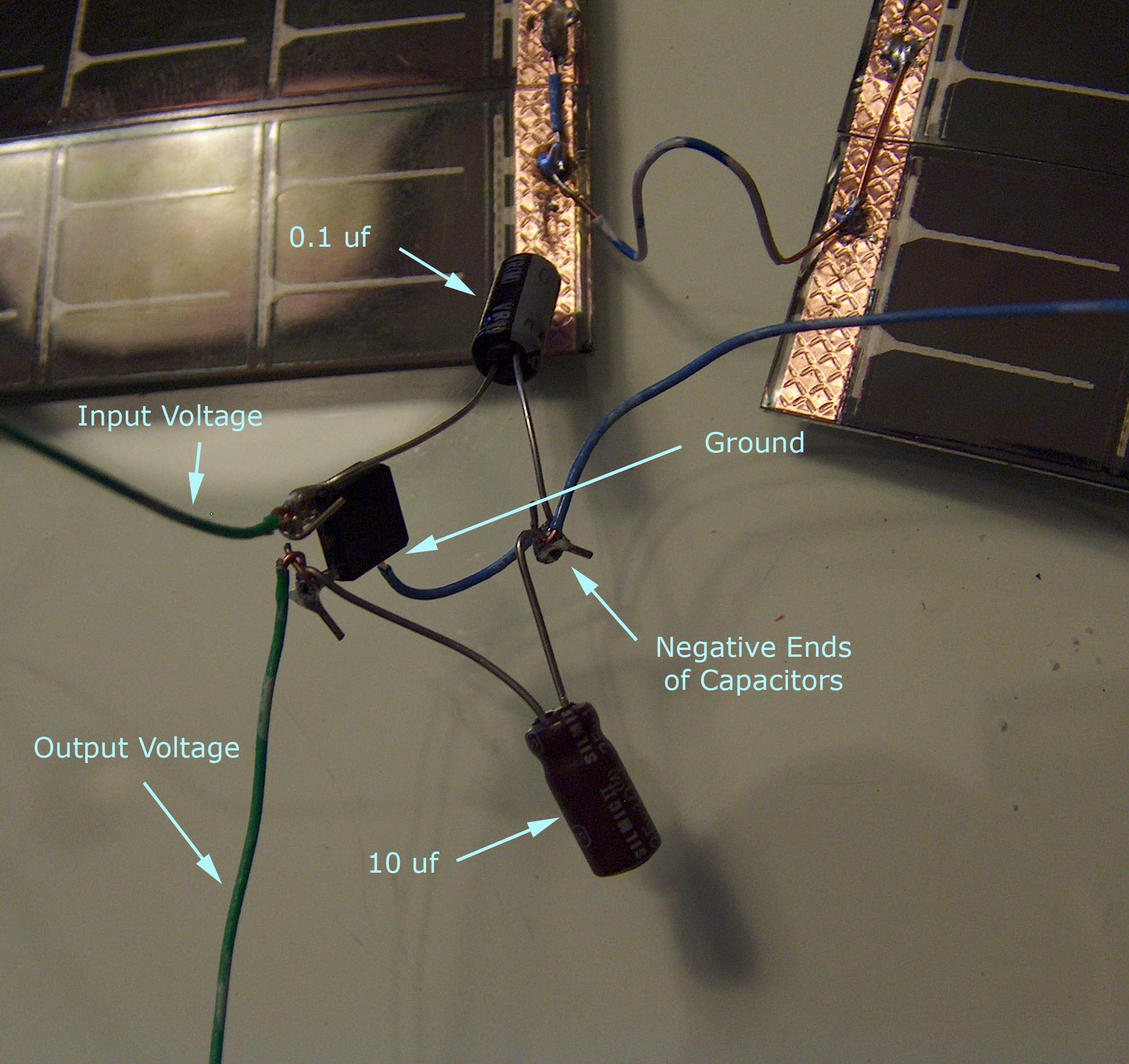

Hi, I made a schematic of the circuit. Just le me know if it's what I should do. I'm pretty sure i'm right with this. Please let me know if I did it right.

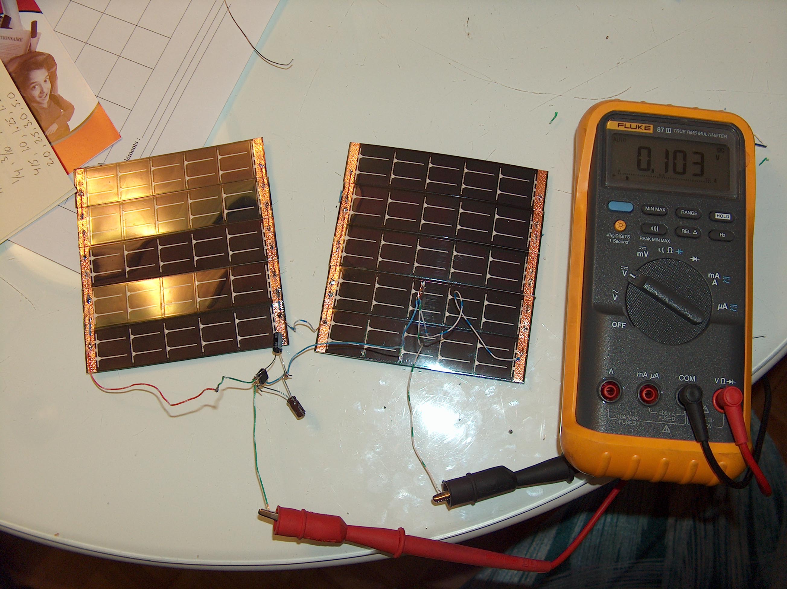

Hi, I've made my little curcuit and something must be wrong? I'm not getting my 3v output like I was supposed to. If you look at the pics, you will see that i'm not even getting 0.6v. I think i've connected everything the right way, according to my schematic. Can you think of something wrong with this? I've observed the polarity for the 2 capacitors, long leg positive and short negative. Could it be my ground that's not right, or maybe my iron for soldering burnt my IC? On my panels I was getting 6 7 volts and nothing good on the other end. i don't really know what to do next?

The connections look fine, remove the solar cells temporarily and plug in a 9V battery to double check things...

YEAH! I've solved my problem, I had a wrong connection. It's working ok now, exept that 125ma seems to be a bit short. So i'll upgrade to 9v 175ma. That should help on the "enough sun" and the current available. Thanks everyone for your help!
