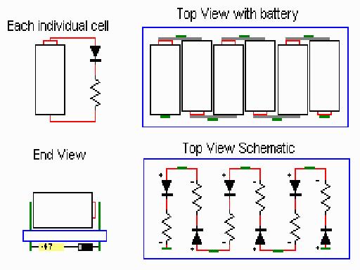

Is there anything listed on the radios about how much current they draw?
a 7806 V-reg should do it, but you might have to add some extra capacitors to smooth out the output.
It might just be as simple as this (of course I'm just a 2nd/3rd year EE student, so there might be more to it):

that's more than likely the transmitting power. Do you have an ampmeter so that you could measure the current draw?
You'll need to buy a voltage regulator that can supply enough current. I would think something in the range of 1-2 amps would be sufficent. If you only use the 'low' power mode, you could get by with less.
I'll bet that someone sells a cig. lighter adaptor with a regulator built in. If you dont want to build it yourself, maybe try to find one of those with a sufficent rating.

I built the circuit using the 7806 regulator schmatic and it seems to work great. I am measuring the temp of the regulator as I transmit and the temp goes up to ~115 degrees. Tomorrow I think I'll add a heat sink and see if it runs cooler. The voltage did not drop during the transmitting, so I assume that I am not overloading the regulator.
Any comments will be welcomed.

A 1A regulator should be fine for a 2W transmitter, but you should certainly add a decent size heatsink to it - bear in mind that the tab on the regulator isn't ground, so you will need to insulate it.
I presume you added the two capacitors shown on the circuit?, they are essential in these 78xx designs.
I was having some trouble (noise) with a handheld amateur transceiver that I was powering from my cigarette lighter. A friend who services commercial mobile equipment noted that battery operated equipment often does not have the power conditioning circuitry that mobile equipment does - so he was not surprized that I was having some problems. A choke (inductor) and a large capacitor solved the problem. In my case I did not need (or use) a regulator since the transceiver input was 13.8 vdc. If noise isn't a problem (as heard by the person listening to you) then I wouldn't worry about the choke and capacitor.
Be sure to fuse the lines from the cigarette lighter so that in the event of a problem that the wiring doesn't overheat. Some plugs have a built in fuse holder.
