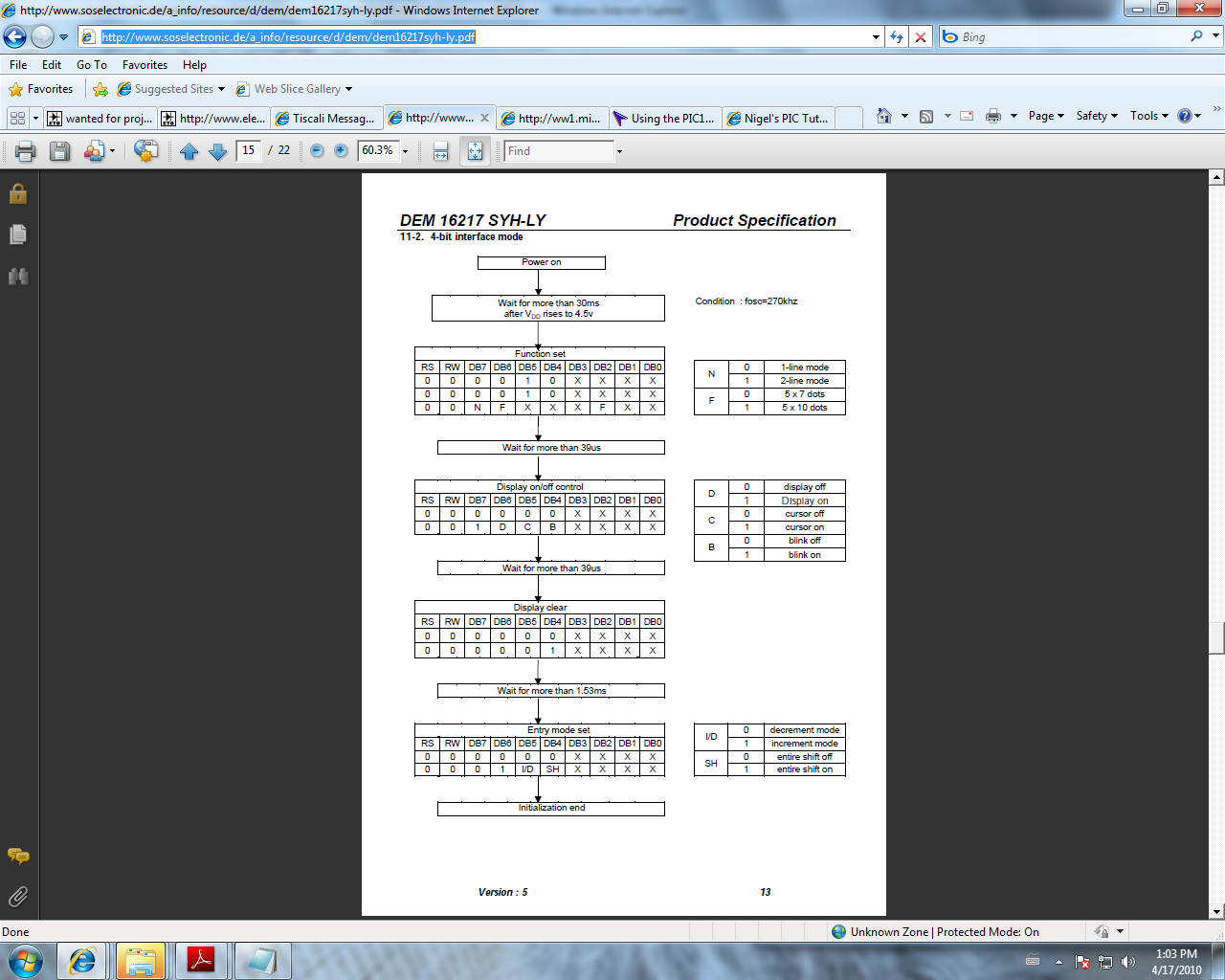

Hopefuly this will come out better.
The code is from nigels web page, i have modified the LCD initilise routine as i could not get nigels to work.
here is a copy of the data sheet for my LCD, i am trying to use 4 bit mode
https://www.electro-tech-online.com/custompdfs/2010/04/dem16217syh-ly.pdf
Attatched somehwere is a image of the initilaisation procedure.
I would be gratefull of any comments

No the modified version does not work - hence why i m really stuck, I am confident that the LCd is connected correctly, i just cannot get it to fire.
I didn't expect the initilisation change to make any difference.

Hi Charlie,
Your modifications to that Tutorial code won't work. The changes should look something like this instead;
;  Initialise LCD
LCD_Init
        movlw   3               ; step 1, "function set" 8-bit
        call    LCD_Nyb         ; write 4-bits only
        movlw   3               ; step 2, "function set" 8-bit
        movlw   3               ; step 3, "function set" 8-bit
        movlw   2               ; step 4, "function set" 4-bit
        movlw   0x28            ;Set display shift
        call    LCD_Cmd
        movlw   0x06            ;Set display character mode
        call    LCD_Cmd
        movlw   0x0d            ;Set display on/off and cursor command
        call    LCD_Cmd
        call    LCD_Clr         ;clear display
        retlw   0x00
