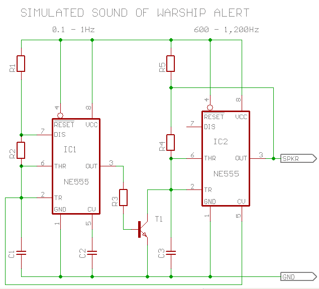

How about that? It's supposed to simulate warship alert. (starts at low frequency and winds up to max - silence - restart).
Anyone tried that yet?

With the latest schematic I posted there is a problem. Whenever the trigger output of timer1 is connected to the control voltage pin of timer2, timer1 quits oscillating. :(
