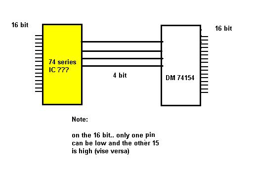

wat is this IC
elmediel
please someone tell me what ic can be used here in 74 series.. thanks
if possible, please give a schematic diagram to complete the circuit..
You can use two 74148 with some and gate. Two 8 to 3 priority encoder become 16 to 4 priority encoder. The schematic is shown in the datasheet of 74F148.
