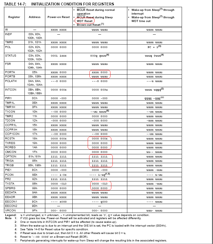

It is possible, but it will be very impractical to work with, and will destroy Values of PORTs, USART, ADC ... I would never use WDT as another timer through RESET. But I would use it to wake the PIC up, this is used pretty often.

Some are more accurate than others. PIC18F1320 I'm working with right now is guaranteed +/-2% over the entire rated temp range.
In cases of less accurate WDTs, one must be careful to ensure the code can provide CLRWDT frequently enough for the minimum period that WDT may use. This is a difficult question since having it working on the bench does not prove it will work with all part lot #s at all temps, and if not it's not just going to be less accurate than intended, it's going to reset the code.
