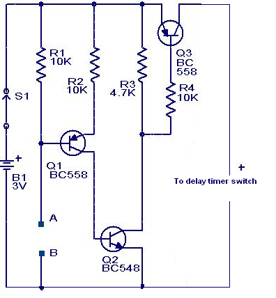

..or you may use this kind of activation connected to a delay timer + led flasher + how you're making the quack sound?

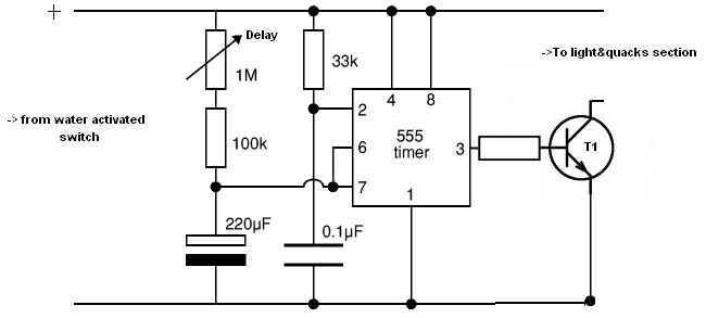

Well, this monostable section can be followed by the water activated switch described above(but with minor modifications regarding the power supply condition), T1 will be swiched ON for a particular time period as set by the pot, so by attaching the light flasher circuit with quacker you get the electronic duck in operation.
PS: You may try alternative methods:p

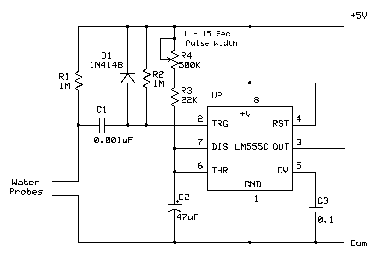

Just bench tested this. Water sensor and monostable in one. :) No need for a special sensor...just two wires.
Ken
