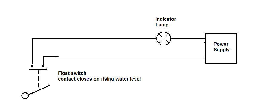

Two wire connection up to the tank, just connect the switch and a lamp in series and connect to a simple power supply.
Job done!

To JimB: What will be the output if we do it using a simple series float-switch like you suggested? The water level will be fluctuating at trigger point because of the falling water and it'll make a intermittent and annoying output? That's the reason I thought of using a monostable or bistable setup. This is my assumption and reply back your thoughts on it.
As per the attachment.
Just a simple indicator lamp which illuminates when the water level is high.
Or you could use a bell or buzzer in parallel with the lamp if you want an audible alarm.
Power supply output voltage to suit the lamp/buzzer.
How is the water pumped?
Using an electric motor?
If you wanted, you could use two level switches and have automatic stop/start control of the electric pump.

I think he wants hysteresis to prevent blinking/beeping alarms as the float bobs up and down at the trip point.
To cruts: The air temperature range in my area is 10C-35C during all seasons. Chance out there that the water temperature goes ~10C below the air during day time. On the other way around it won't be more than a couple of C if ever happens.
To JimB: The pump is operated using electric motor. What I meant is the problem described by Jaguarjoe.
To get hysteresis action with a float you could do something like on some sump pumps. The have a float on a sliding vertical rod. There are two clips on the rod to turn a switch on and off. The lower clip turns the switch on and the upper clip turns the switch off. The distance between the clips determines the hysteresis level distance of the water. Here are some commercially available.

Most good quality float switches allow for hysteresis to avoid the constant on/off problem. Good float switches are enclosed in a baffle to compensate for any sloshing around. All things considered I would just install a good float switch.
