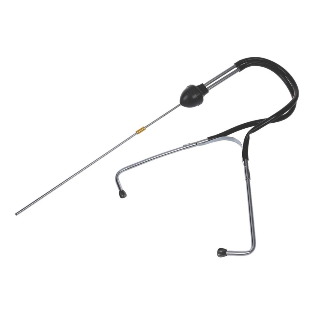

Does anyone have any recommendations at all?
Get a "Mechanics stethoscope" so you can put it against pipes or taps and listen?
That may help pin down the area of the leak.
