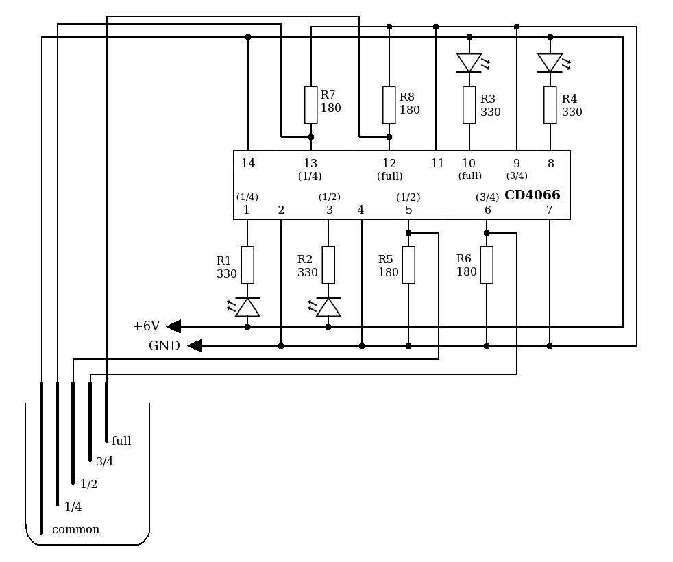

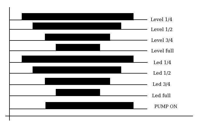

I've found this scheme for a water-level.
It has only visual alarm but with a NPN it's possible to connect a buzzer through pin12.
What I want to do is connect a pump that works like scheme:
ON - when level

The CD4066 is a Quad Bilateral Switch so you have 4 switches in a single package. If you read the data sheet and note the control lines you will understand how it works. The pin you mention is a control pin and one of 4 control pins used to turn the switches on and off. Pin 12 happens to be the control pin for switching the switch across pins 10 and 11. It is an input to the chip and not an output.
A problem I see with the circuit as posted is that there are no dimensions for the sensor? Most circuits like this are sort of hit/skip as they rely on the conductivity of the water (or media) they are sensing. The conductivity of water can vary considerably from geographical location to location. Rain water, well water and tap water all have different conductivity.
Can what you want to do be done? Maybe but you would use the 1/4 tank level to initiate a pump and the full level to stop the pump or the reverse if you are pumping the tank down when full. Remember if you start a pump you need to stop the pump and the same is true for a buzzer.
Read the data sheet and think about what you want to do. I won't say don't build the project but think about it a little.

This circuit will have problems with electrolytic corrosion on the probes as well as the problems of varying conductivity of the water.
I would not use this circuit for anything other than a temporary installation.

First off I guess it's not a good idea to sense water level using DC.
Besides possible lime deposit (increasing resistance) on the probes they will experience electrolytic processes resulting in dissolving probe material.
Better to use AC, which can be accomplished using symmetrical power for the probes.

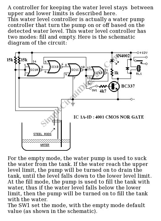

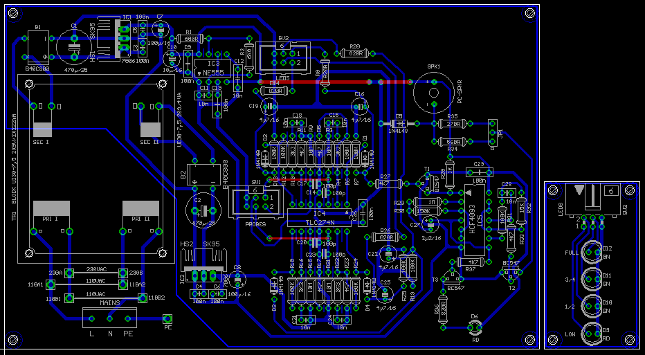

Here is my idea of a four stage water level indicator with audible alarm at 1/4 tank level.
The outputs of 1/4 and 1/1 can be used to control a water pump using logic gates:
Logic 1/4 probe dry and 1/1 dry (what else?) -> pump on
logic 1/4 probe wet and 1/1 dry -> pump still on
logic 1/4 probe wet and 1/1 wet -> pump off
The circuit didn't fit on one sheet. Therefor it's split into sensor and alarm circuit.

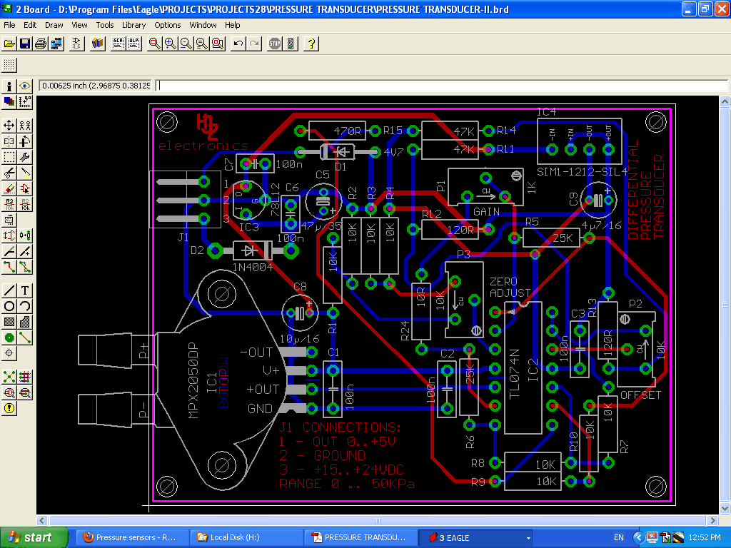

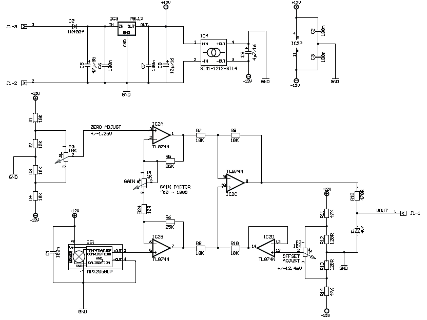

Yet a corrosion and lime free solution:
Use a pressure sensor rated for the pressure of your water tank.
Here is super accurate example of a circuit measuring water level accurately to 1mm water height.
Boncuk

I totally agree with many users. Using DC for water level detection is a sure-fail solution on the long term. especially with the schematic i saw ( 180r is WAY too low for a series resistor). A pressure sensor will rely on water pressure rather than water conductivity and will not lead to elctrolysis based corrosion. Another solution i saw on a sump pump: An insulated tilt switch inside a float.
Anyway, If you decide to continue with your project, i suggest adding a transistor/MOSFET to amplify the current and a relay to provide isolation between your DC project and the mains.

I've make an error typing how it works.
The pump is ON when level arrive at 3/4 tank and stop when arrive at 1/4.

Whatever method you'll use I guess pressure measurement of the water column is the most precise and reliable way.
Since the compressed air is trapped in the pressure hose there will be no way for dirt or algea to enter it. Even if algea grow inside the pressure hose they won't close it air tight and leave a cavity big enough to sense water column pressure.
An annual inspection and cleaning (or replacement of the pressure hose) will take care of a long time reliable water level measurement without the need of recalibration.
