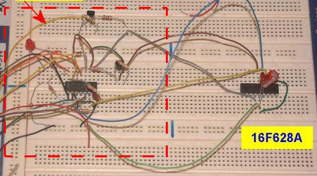

Pearlyred, please visits the first link in Nigel's Signature and obtains the schematic of the P16PRO40 programmer. It uses one TTL IC, a few PNP transistors and two voltage regulators. Very easy to build. I even did one in a couples of minutes in the past. See image. There are also ready made one up for sale in EBay.

Oh! - so nobody mentioned it then?, you select ProPic 2' in IC-Prog.
Ok, I'll go with the 16F88 and P16PRO40 programmer, minus the ziff as Im not rich at the moment. I'll take a look at the schematic (need to get better with these) and make up a parts list. I cant get the parts until a couple days time, but when I do i'll have a go and see where I get. This should be fun.
