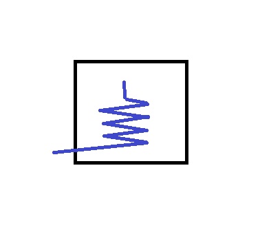

But I often wonder what if i move the condenser like this so that the steam inside transfers heat to the water that needs it, thus recycling almost all the energy. but I have seen no setups like this which leads me to believe there is a flaw to my plan. Can anyone see it?

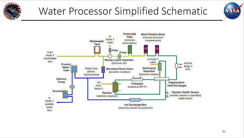

I know nothing about septic systems, but with reference to recovering heat from distillation, the ISS WRS does just that.
In this schematic its done in the box with the green dots running horizontally labelled 'regenerative heat exchanger':
The same document has the sentence: "The process is very energy efficient as the heat of vaporization required for boiling of the pretreated urine at reduced pressure is provided by the condensed product water."
Of course, they have the advantage of being able to reduce the pressure of the water -- thus reducing the energy required to make it boil -- for free; whereas you'd need to run a vacuum pump to do that on earth.

I believe that there is a flaw to your plan, sorry. The water coming out will be at 100°C.
I would suggest you have a look at a "counter-flow heat exchange", which should extract almost all of the energy, and the water outflow temperature will be very near the inflow temperature. As I understand it, a counter-flow exchange is basically the continuous (i.e. "infinite"-stage) version of a multi-stage exchange system.

If you are distilling the water, you can recycle most of the energy of evaporation if you reduce the pressure of the steam to slightly below atmospheric pressure with a vacuum pump.
The feed water will then be boiling at slightly less than 100 °C. Converting water to steam is where most of the energy is needed. The steam is drawn through the vacuum pump, and as the pressure rises to atmospheric pressure, the steam will condense at 100 °C, so slightly hotter than the temperature that the feedwater will be boiling at, so a heat exchanger can recover the energy of evaporation back into the feed water.
The condensate can pre-heat the cold feed water up to near its boiling point with a contraflow heat exchanger.
There are losses, so external heat is needed as well, and power is needed to run the vacuum pump, but the overall power use is far less than is used simply boiling the water.
I think of it as a heat pump to pump the heat from the clean steam back to the boiling feed water, but a heat pump that uses the steam as the working fluid.
Water purification systems like this are used quite a lot. It's called Mechanical Vapor Recompression if you want to search for more details.

My apologies, looking back at it im not sure why I thought having an internal condenser would make things better... but i could still rig it to use externally, as long as the water coming out is same temp going in that still counts for efficency, right? , I wonder if there is anything else i can do to boost that efficency.
