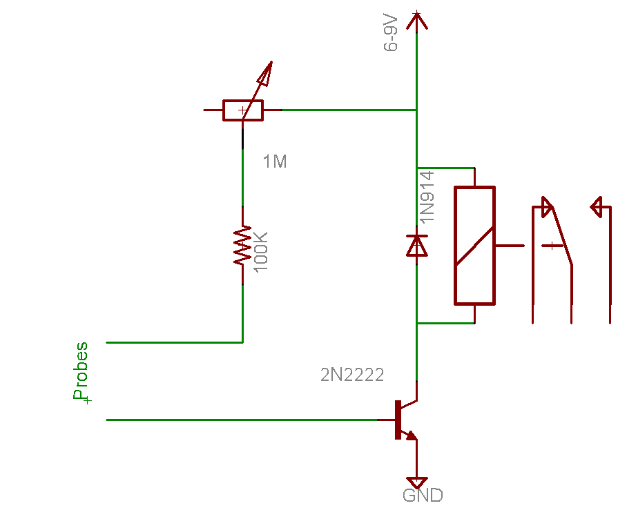

You could build a simple set of moisture detectors to find out the water level. Water conducts electricity, albeit poorly, but enough to be detected and amplified by a simple transistor.
Any simple NPN transistor will work, from 2N2222, 2N3904, etc.. The relay should have a 500 Ohm coil or so. This circuit will close the relay when the moisture level exceeds a level set by the 1M variable resistor.
The probes can be bare metal or wires.
You can modify this to switch on higher powered devices like the pump or use more sensors in a column with a transistor array. I personally think you'd be better off with a mechanical solution...far safer.

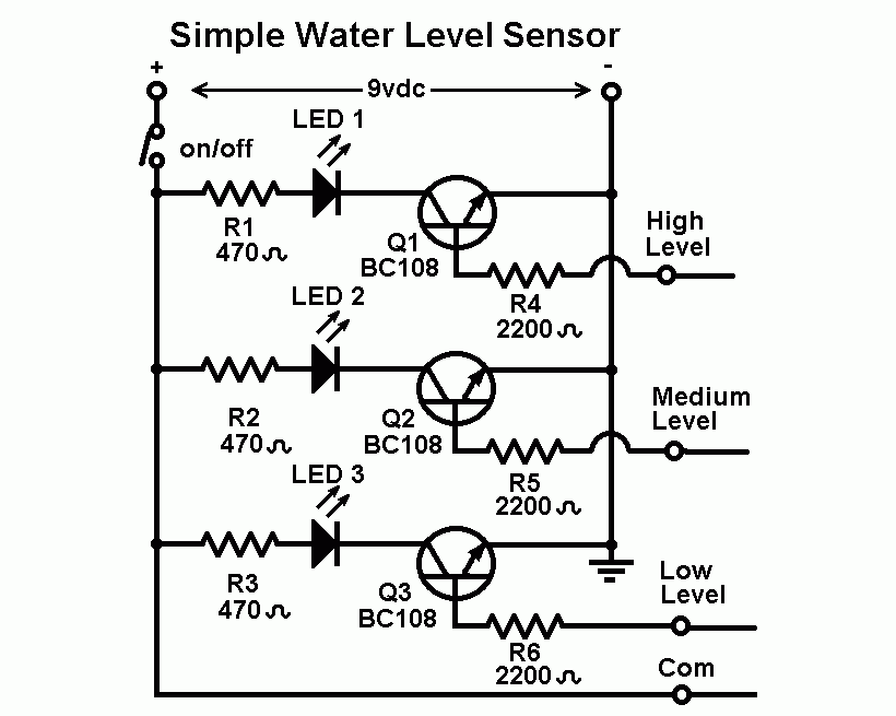

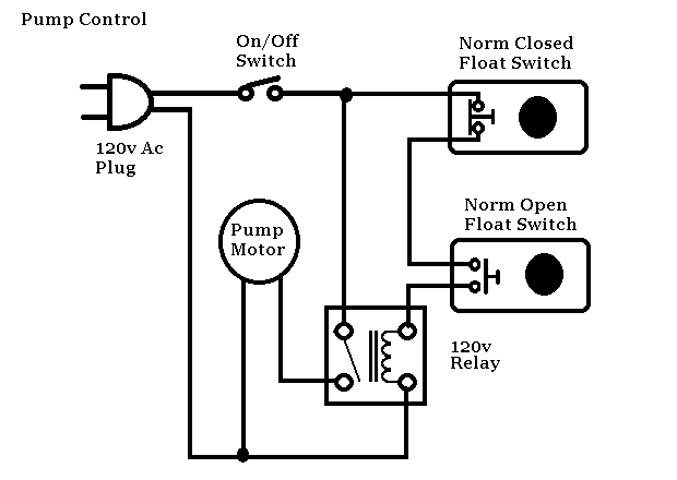

How about these circuits?
Hi everyone. Im doing a project on my second year Btec and i am going to use the simple water level sensor diagram above. But I need to know how to connect in my pumnp to start on the high level and knock off on the low level. also i will need to connect a valve to let in water on the low level and stop on the high level. Opposite to the pump really. Any and all advice will be much appreciated!!!! thanks
Did I understand well. that I could use the schematic of hotwaterwizard to allow me to fill a thank automatically using a normal float switch pump. My system is this. I have a float switch pump that stop when the water level drops below certain limit in the well. To fill the tank I have to switch it on manually since it never stops even when the tank is full. Could I use that.

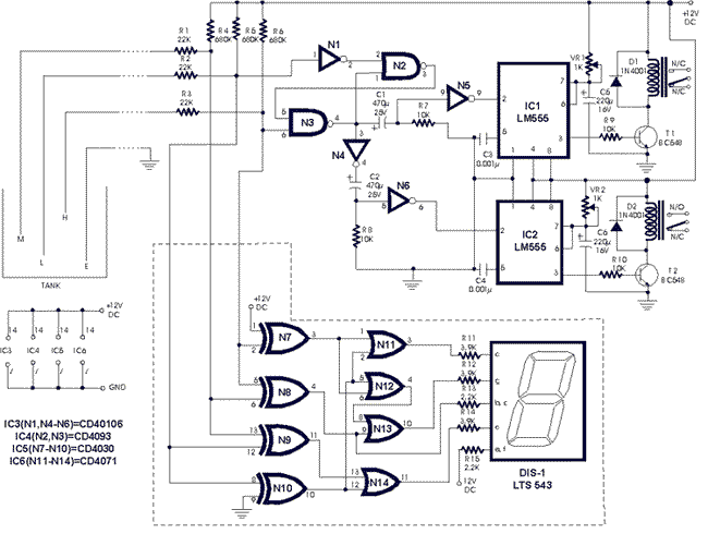

I am a little late here too. Something simple.
A PVC pipe vertical in the liquid, a floating material ring cut to slide up and down the pipe in the liquid with a magnet in it and use reed relay switches inside the pipe.
As the foam ring floats up and down it will short the reed to tell you the location.
simple and working solution for pump controll.

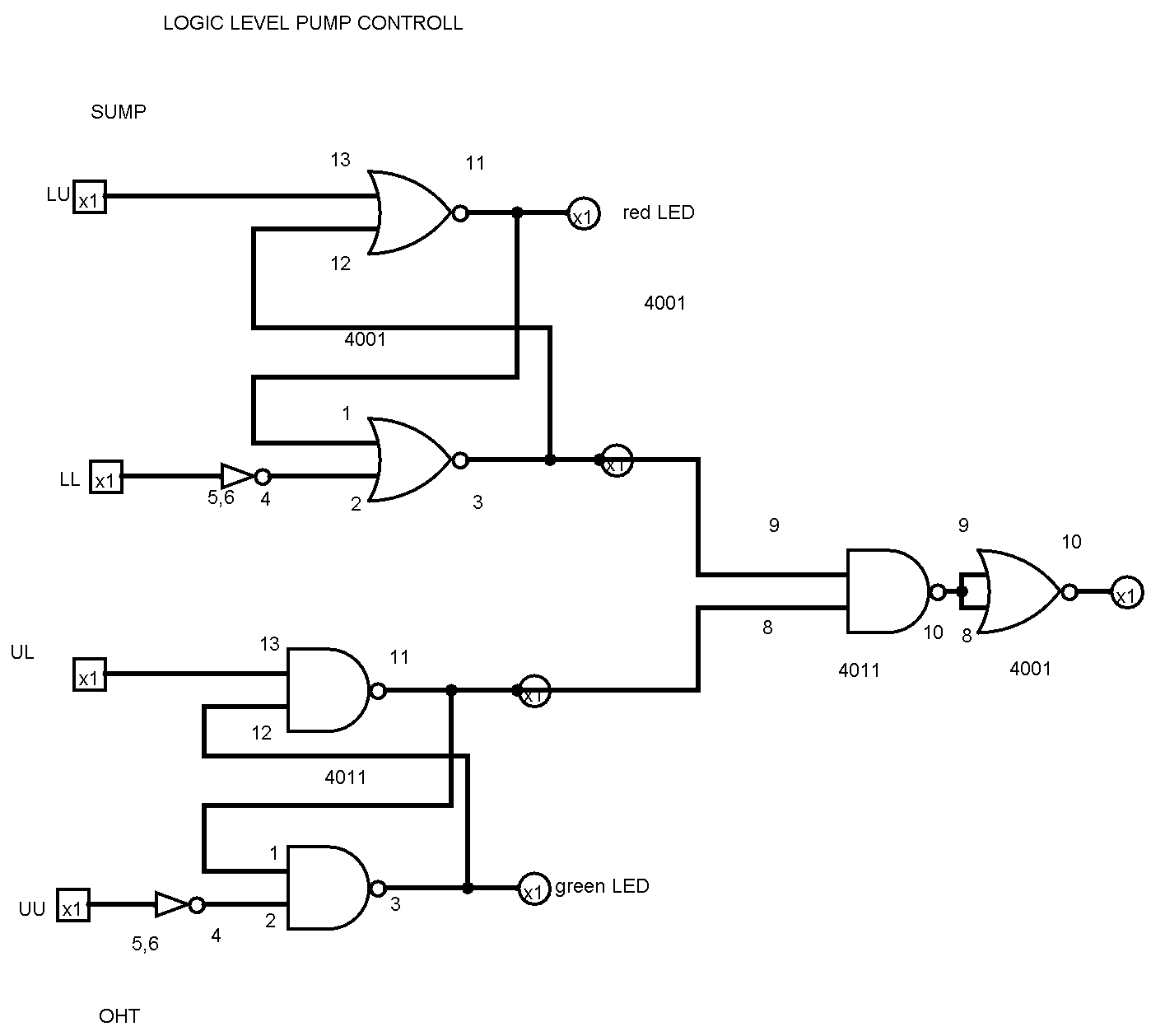

hello friends ,i have developed a simple but efficient water level monitor and pump controller for OVER HEAD TANK.it has an added feture of monitoring the water level in sump or well if needed.i developed it mainly for my home,where i need to pump water from a small tank in my basement to a large OHT(over head tank).iam using it for last 2 months without any problems.:) .i have serached for a circuit like this for weeks,but couldnt find one.so i designed it using CMOS 4001 & 4011.the pin numbers are clearly shown to make circuit idea to practical solution easier.
The input to the logic gates can be either through a float switch or signal through a pair of conducting probes (which need to be amplified using transistors).from circuit its clear that it works on S-R latch feture of logic gates.i have provided visual output for the staus monitoring(it works in a limited way though)of tanks without extra wiring.the building cost for the circuit is less than 10 usd including the mechanical relay and delay circuit(delayed turn -on) used with it(to prevent rapid switching).
i am not at all worried about water level in my OHT now.PLEASE HELP ME IN MODIFICATION OF THE CIRCUIT WITH UR IDEAS.and kindly correct the mistakes i made.iam a physician so not an authority in electronics.for suggestions and any queries u can mail me.

problems with the circuit
one change in the circuit.for noise immunity i have used 4093 schmidt trigger IC instead of 4011(i have only a broad idea about all these,iam not sure if its appropriate).
after 2 months of continuous use the one problem i have faced is .sometimes if you switch one and off the circuit rapidly after 3 or 4 attempts it will turn on the pump regardless of water level status.but if the water level in upper tank is at it maximum or in sump if it is below lower limit it will turn off pump immediately(anyway pump wont run dry or no overflow,it fullfill the purpose):D )
out put from logic circuit is amplified using a darlington pair to drive a 100ohm 6V relay.this raly is used to switch on a delayed turn on relay circuit which switch on the main terminal to pump.(please see the pdf attchement).
any suggestion to improve the circuit ??:confused:

Lots of cases it may be necessary to reduce the voltage of the components that are in the water to 24volt or lower in the interest of safety. The 24 low voltage supply is then used to feed the coil in a contactor or relay which in turn operates the motor in the water pump. For domestic installations
a "differential " float switch is often used. Differential meaning a significant difference between the start and stop levels. so that the pump does not start and stop too often and cause excessive heat to develope.
