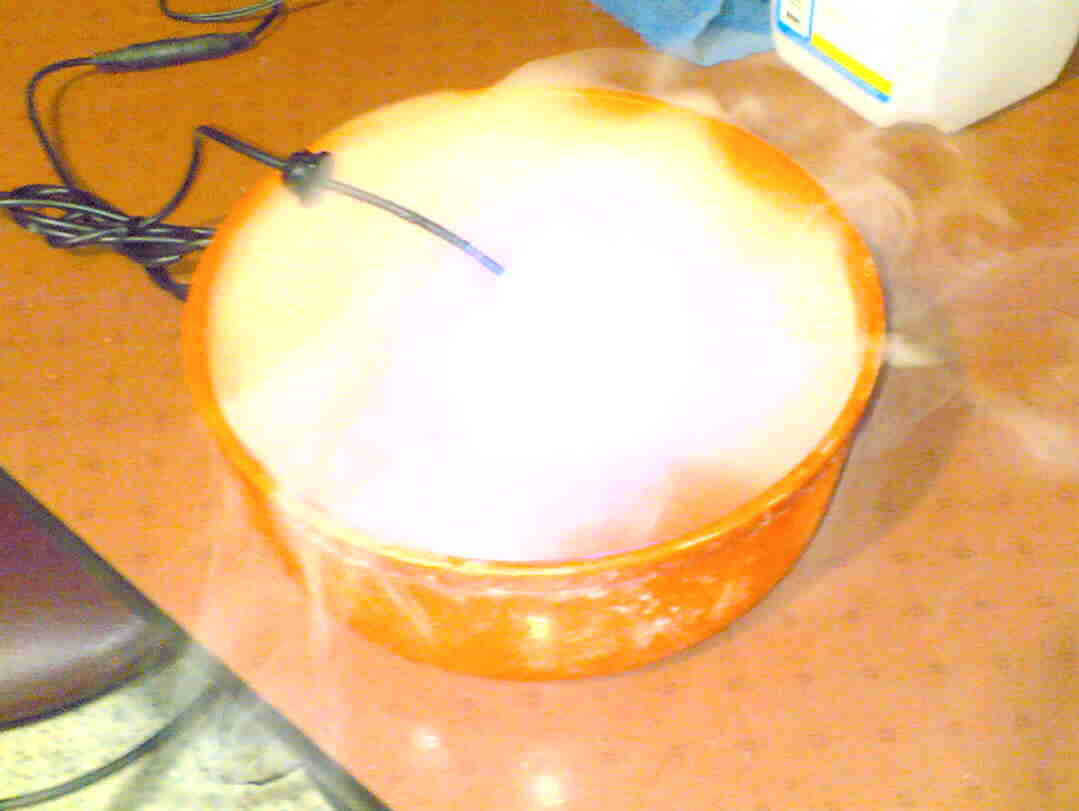

How about using cold mist?
The mist will distrubute over the entire water surface allowing to cool the aquarium water (with the filter pump running).
Here are some screenshots.
This mister is made of stainless steel and can be dunked into the aquarium.
Boncuk

Cold mist reduces water surface temperature considerably and with the water being circled by the (most necessary) circulation pump it will attain the desired temperature.

Just some numbers using a cold mister rated 24VAC/1200mA. Initial temperature 32.7 deg C. With cold mist activated the water surface temperature dropped to 27 deg C within one minute (bowl content approximately 1 1/2l). To create a temperature drop of 5.7 deg C (by evaporative cooling) you need a fan causing waves on the aquarium water surface and I doubt a fancy CPU fan will be able to do that.
CPU fans are axial fans with low pressure and high volume. To create waves you need a radial type fan with high pressure at lower volume.
I certainly do not intend to talk anybody into anything, but these are the facts.
