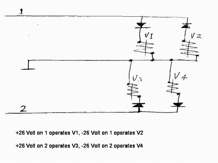

I have a programmer for watering my garden that is far from it. The plastic tube that conducts the electric wires from the programmer to the electrovalves is blocked and is impossible to add more cables or even to pull them for using as a guide. Now, there are 2 electrovalves that are controlled by 3 wires from the programmer (one mass). The problem is that I would like to add 2 more electrovalves. As it is impossible to add two cables, I am wondering if you see any method to convert the signal that generates the programmer for four valves (the programmer can control up to 4 valves) in a binary code who travels along one of the cables. Then, in the garden demodulate the signal convert back in a signal for 4 electrovalves. The other cable should be used to provide the supply for the valves (26 volts AC).

Why not change the valves to 12V ones and use the 2 halfs of the 26VAC to control 2 valves through 1 wire (plus ground). See attached.
You could use 26 Volt DC rather than AC and thus Mike's solution would work.
But I don't know whether the valves can be used on DC. Does anyone know?

I think you misunderstood what I was suggesting. The circuit I posted earlier will take 2 outputs and drive 2 valves independently through 1 wire. Or, it will drive 4 valves through 2 wires plus 1 return/common wire. There is no need for 2 valves to be on at the same time. This may even work with the existing valves if suitable capacitors are put across each valve.
Look at the circuit again and if it doesn't make sense then post back and I will explain how it works.

the lawn sprinkler valves I've tinkered with are rated for a 24vac system but work fine with 12vdc. It's just a simple solenoid that moves a plunger, give it enough energy and it does its job. I figure they specify the 24vac because it carries a lot better over 100's of feet of cable than lower voltage DC would.
Pommie: sorry for the misunderstanding. Your idea looks fine, now that I have looked at with attention. I will test if valves open with half tension. Regarding the post from ljcox, I think that this solution only will work with AC ¿?¿?
As far as I am aware, this will only work with AC. I think what Len meant was to smooth the rectified AC at the valve end using capacitors.
I would just try it as drawn and if it isn't reliable add capacitors until it is. Let us know how it progresses.
No, I did mean DC, see attachment.

How do you turn ON V1 and V2 at the same time? Using AC you get fully independent operation of 4 valves through 3 wires.

He only wants one valve on at a time.
