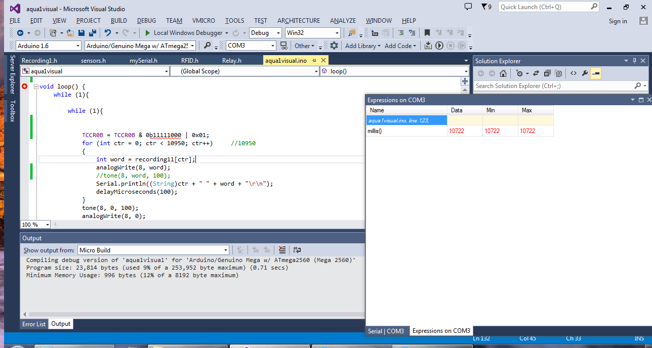

thanks guys, but few problems seem to have arisen:
TCCR0B = TCCR0B & 0b11111000 | 0x01; // <------ compiler shows error, says there is semicolon required at the binary value,,, but seems to compile , so maybe we dont need to worry, plus my delay is timed out by ear with original track and even though only 5 or 6 seconds long in total offset is only 1second, so close enough that i should be able to make out words
TCCR0B = TCCR0B & 0b11111000;// | 0x01; // <----- even if i do this
but also I should have mentioned mega2560, it seems analog write is not an option for me, but thanks for pointer as i read a bit about it but didnt realize it was for pwm pins,

My BIGGER problem now is that just for test i decided to output word values to serial port:
Serial.println((String)ctr + " " + word + "\r\n");
but it seems there are alot of false values coming out , such as a series of:
10941 44
10942 44
10943 44
10944 44
10945 44
10946 44
10947 44
10948 44
10949 44
