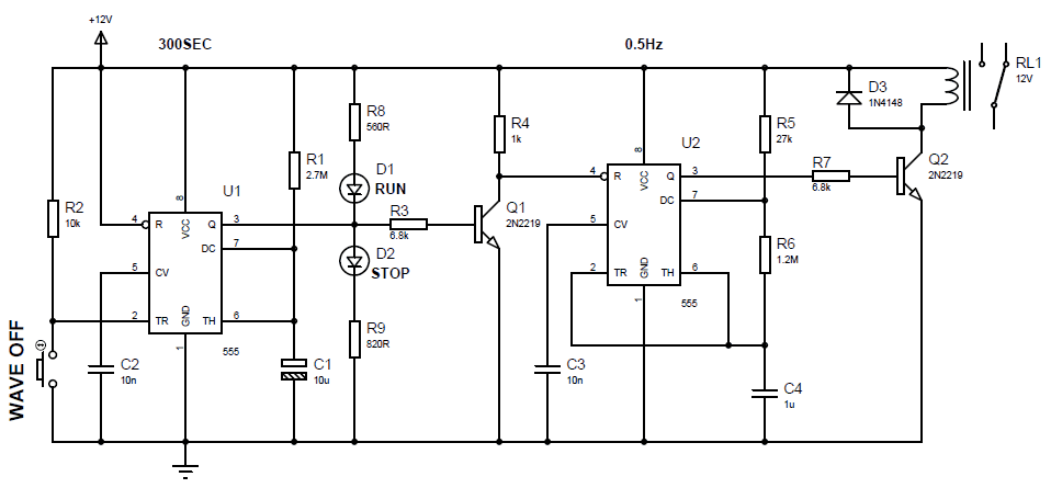

i am building an Aquarium wave machine - i have a pump which i need to control and the wave action is done
the pump transformer has a din 5 fitting - one wire is positive, one is negative one is control
i just hooked a 555 astable to the control and that's done - when output is hight the pump is on
BUT! i am now trying to add a feeder function where i have a monostable that turns the pump off for 5 mins or so while i feed my fish then the pump starts again
now the part i am struggling on is hooking it up to the control pin - i think i need it wired so that the astable turns off when the monostable is triggered
i have managed to do it the other way round where the astable is off unless the monostable is triggered by powering the astable from the output of the monostable but thats no use really
- so how do i make it do the opposite?
if anyone could help me out that would be great
thanks alot
