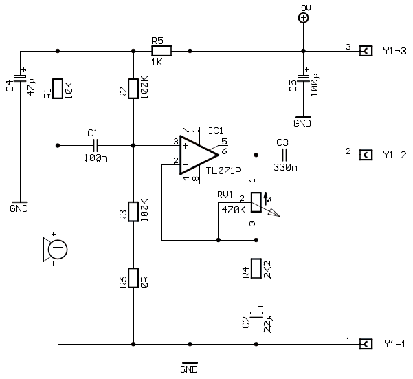

I know comparatively little about electronics, so please bear with me!
I've been working on a little project to record sound with my Zen MP3 player, which has the ability to record at 160kbs. However, it only has a line in, so to get sound from a mic, it needs to be amplified.
Now, I've got it pretty much sorted by using the pre-amp and amp circuit from one of those REALLY old Sony Walkmans, and a little circuit to power the electret capsules. Although this works very well, and the resulting sound is more than I could have hoped for, there is WAY (!) too much bass. Although it can be EQ'd in editing software, it makes the signal overload very easily.
Is it possible to make a simple high-pass filter for the mics before they enter the amp, and would it solve the problem?
Also, why exactly is this happening? Could the amp be boosting the low frequencies for some reason?

If you were using a self-built preamp for which you have a schematic diagram, tailoring the frequency response would be simple. Since you likely do not have a schematic of what you are using, it is very difficult to suggest a fix.
I've just done some tests and it's definitely the amp that's boosting the bass (they must have designed it for a cassette head that lacked a lot of bass or something). As you say, without a circuit diagram, I'm stuck. :( I'm guessing that it'll be extremely naive of me to wonder about using a photo... lol
So, I guess the only way around it is to make an extra strong high-pass filter for the mics. Are they reasonably simple to make effectively with some capacitors?
You're using a tape preamp, NOT a mike preamp, so it's completely wrong - it would be easier to build a proper mike preamp than to try and build a filter to correct the other, which would reduce quality as well. AudioGuru has posted a suitable mike preamp circuit here MANY times - and it's available as a 'sticky'

IIRC, magnetic heads (tape heads) have a voltage output that rises at 6dB/octave (with increasing frequency), which has to be compensated in the preamp by a 6dB/octave fall in response. If you drive the amp with a mic that has flat response, you will wind up with massive bass boost.

It's not as simple as that, it applies different levels of boost and cut at different frequencies, similar to the RIAA curve.
Like I said, dump it and build a proper preamp.

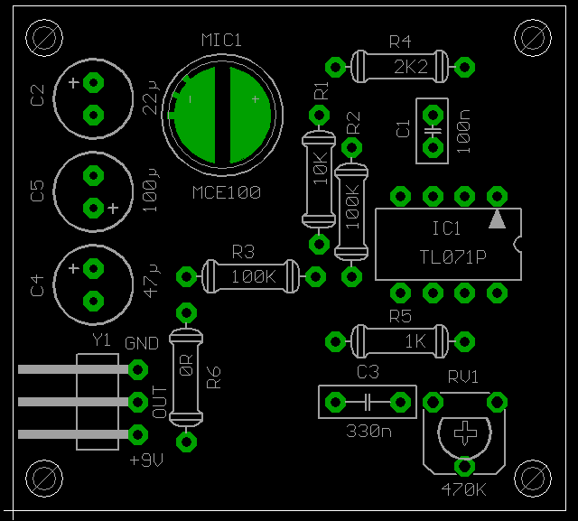

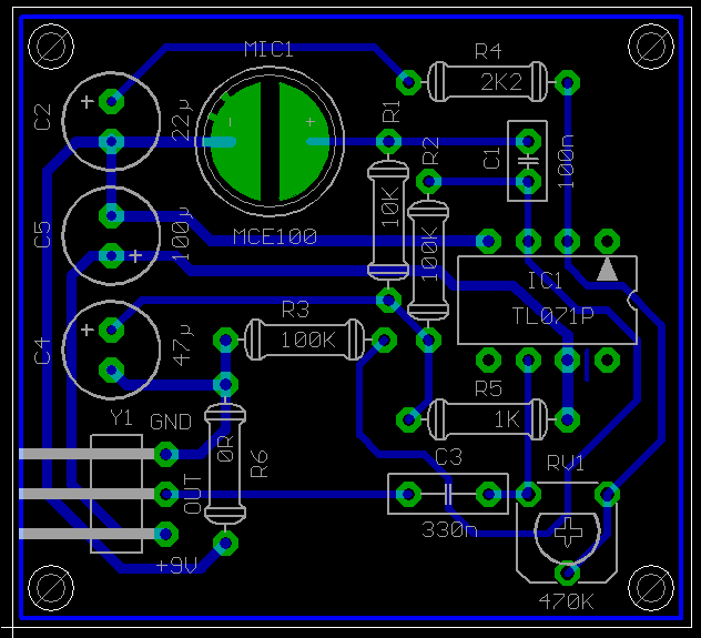

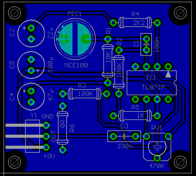

Hi TheGuy,
I made a nice PCB layout of audiguru's preamp. The board is purely single sided with a small cheat (a zero Ohm resistor to avoid a trace between between connector pins)
Board size is 43.5X40mm (1.7125X1.5625").
The electret microphone is located on board, but there are two large pads to connect to cable if necessary.
Here are some screenshots: schematic, PCB-layout, layout with ground fill and silk screen.
If you're interested in building the board please PM me for the Eagle files.

So, audioguru, I'm going to take a crack at your electret mic preamp. I do have two questions before I start my electronic adventure, though.
Does your circuit provide power for the electrets? If I was any good at electronics I'd be able to see from the diagram, but I'm not, so... :D
Also, because the Zen has NO amplifying at all, it requires quite a loud input to be just under clipping. If you'll excuse the non-precise comparison, it requires something similar to an MP3 player on 2/3 volume. So, because your circuit is a pre amp, it'll also need another amplifier afterwards, correct? Or will your circuit amplify the mic quite a bit more than I'm thinking?
